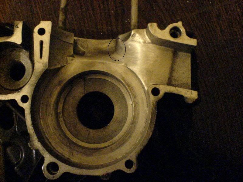

    did i just spot some evidence of grind work? show me a pic looking straight into the case (looking at the bearing seat basicly)
  17. JakeSP
    JakeSP New Member
    391
    Will smooth out the gougey bits tommorow morning (other side is almost identical)
  18. MiNoR cOnFuSiOn
    dont be afraid to take this area back... still looks like 3 angles where youve smoothed it out but the start of the grove is spot on for where the reedblock sits so wont rip reed petals apart when using a plateless block. still looks nice tho. first go?
  19. JakeSP
    JakeSP New Member
    391
    Had a quick practise on some knackered casings before which seemed ok :p
