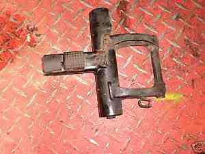

    iv got a nrg project using a gilera runner 125 engine, and im finding it hard to find a engine mount/swingarm, does any1 know if a 125 runner mount/swingarm will fit in a nrg frame??
    thanks.

    can u see how the main bar on the mount has more clearance on the right side, this is the reason that the engine sits the the right when the mount is turnt upside down, and if it isnt turnt upside down the bore will smack off my frame when riding.
    i need a newer nrg mount which is totally equal each end, so it wil centre the engine, plus with the newer ones it doesnt matter what way u put it in the frame the engine will sit bang in the cantre.
    thanks. :mrgreen:

    that engine mount si fine, the engine's ALL mount offset! the 125 fits BUT theres no silent block mount so the lkot just flop's about (LOL to anyone who has tried and RIDDEN like this LOLOL) dont do it..
    just grind it down, yes theres more to do one side than the other but its a case of try it and if its wrong grind further and add a washer one side.. if i remember correclty you leave 1mm on the shortest side then cut it so it is about half a mm (like literally a tiny bit) too big then pry the bush over it (screwdriver through the other side, pull it towards the back of the engine) and it will sit nice an snug. make sure you cut it VBERRY flat (ur cut one side long then file both to length with a BIG file (2 ft long sort of size LOL) and it will all be lush.
    the engine does strike the frame but its only the bleed nipple, you can just replace this with a bolt and ruber washer so it is shorter and bend the area of the frame slightly so it doesent strike at full suspention travel..
    if its an nrg frame the shock is longer than a typh shock so you need to fit a riser really.. if its a typh frame just fit an nrg shock
