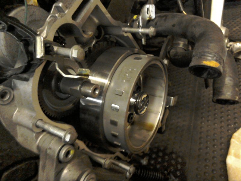

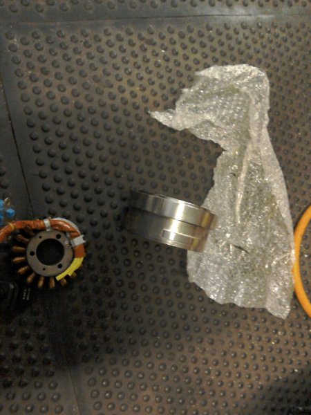

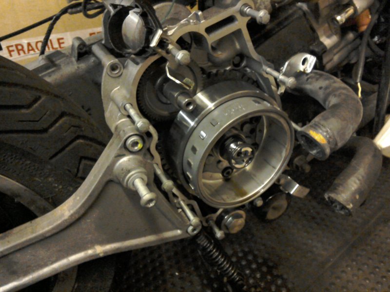

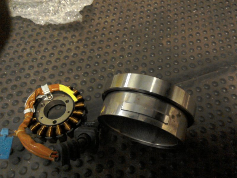

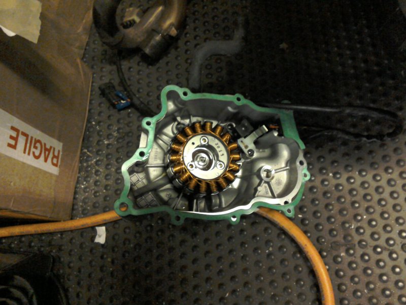

Quick update! Here are some pics of the current gts rotor and stator. As you can see from the pics on the gts there is multiple pick ups for the injector system,fuel pumpand exhaust sensor valve. The weird thing is it did run smooth once for a brief time on this set up then went to pot on 2nd try. So the other pics are of a new stator and rotor to put on. When compared to the set up on my dna the rotor is the same with the one long pick up. But the stator and rotor was the other way around and this stopped me from using them. I I have now finished with help of my best mate finishing off my sons dna gp50. The water pump had failed but was left to rot by last owner. After a quick check and none of the bore. Top end rebuilt and we went about fitting the new water pump. Well after bashing the seized thing out and rebuilding new one the nut off the back off the other side of the prop that was fiddley to get back on and inline while trying to catch the thread. At the last moment before resulting to ful strip it caught. Quick put back together and it started but wouldn't rev out the died all together but was holding water so 1 job done. So after changing plug and checking sparkplug and coil all was good. So thoughts went back to maybe crank seals blah blah.... So we checked the reed valves and hey presto word reeds so we made new ones fitted and it lived . so its had new race pipe DE restricted, carb DE restricted and jet drilled out to a 75 and new malossi belt which is now cleaning up the variator and clutch. So my lad will be happy as his CBT is this Saturday. I will keep you up to date as I make progress but we are getting closer and I now have more spare time to continue.
