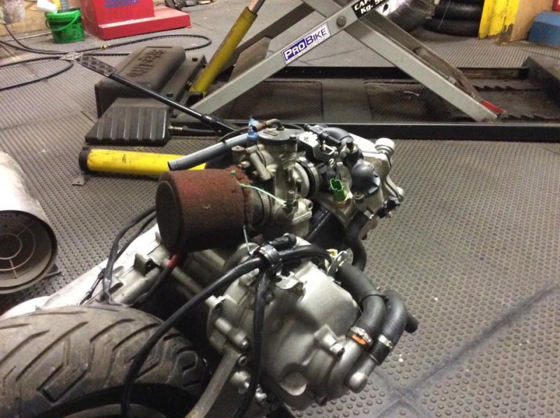

So i can just put it in the correct hole then??? hey presto 14" wheel??? Great news after speaking to Zak @ Fowlers of Bristol he was impressed with the project and has advised me that other than a bit of wiring it should work on carburettor off the current stator plate just need to use pick up wires and discard all the other sensor wires. just need the time now

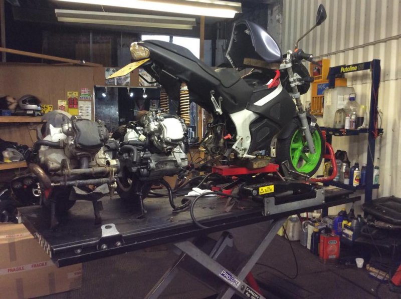

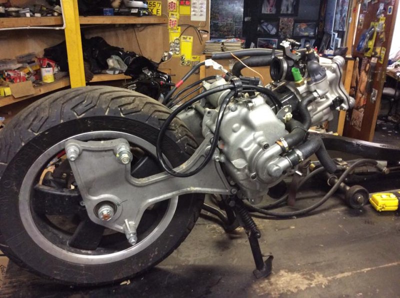

Taking ped to garage this Thursday where I shall whip the old engine out and in with the new ... then mess about with changing to carb whoop I will take some pics on phone and upload when I get a min
ok here is a update on the project... my carb goes on no probs just needs a small spacer so it fits better. but have a new idea with the injector part of the manifold and that is to use for nitrous hahahaha just need a bottle and button to press . its out with the old leader engine today as well and in goes the 300 lump i will update pics when i take some more

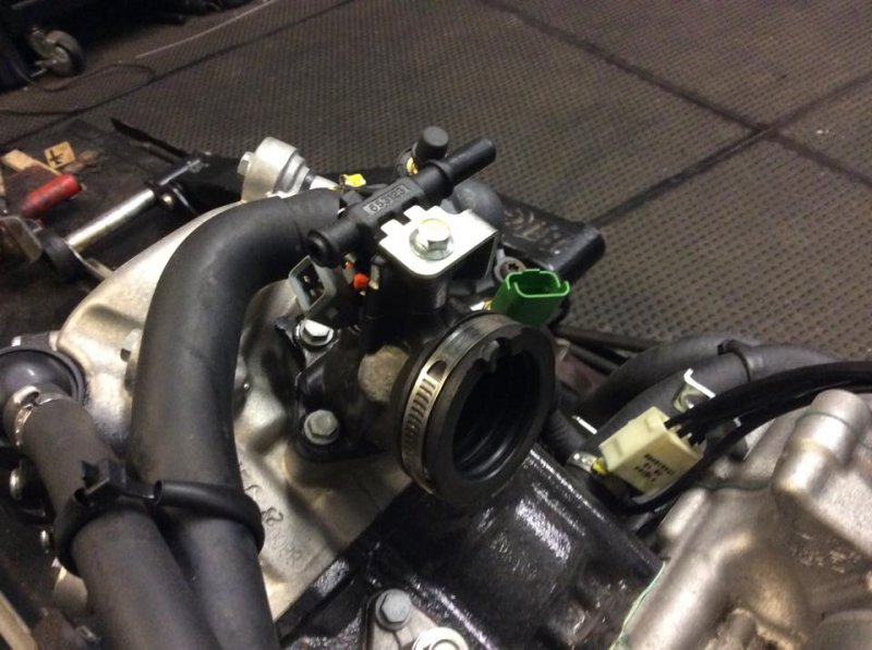

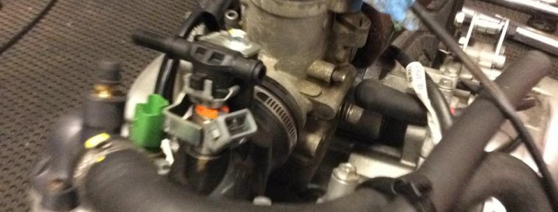

this is the gts with injector body off it . as you can see from the 2nd pic a small mod and I should be able to direct Nitrous Oxide it. Think I found the kit via sip germany they do a universal kit for scooters. This build is getting better and better .
I can see the piston and rings going on it with the first shot of nitrous, small engines aren't made for it.
both engines side by side the engine mount needs new bearings but pm tuning mount is more beefy so its been ordered
