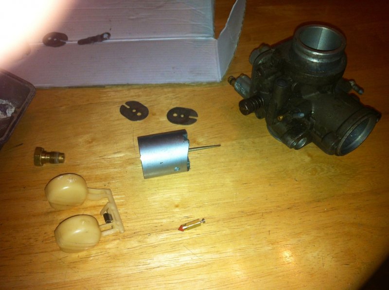

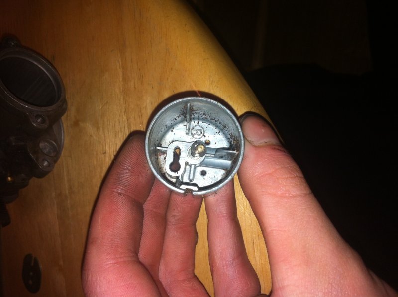

    i got given two dellorto phbh 28mm carbs off a mate, but there both in pieces. I have no clue where things go or what pipes do what? Also how would i attach throttle and choke? Ill upload pictures off my phone now.

    Dont know what all the bits do:/

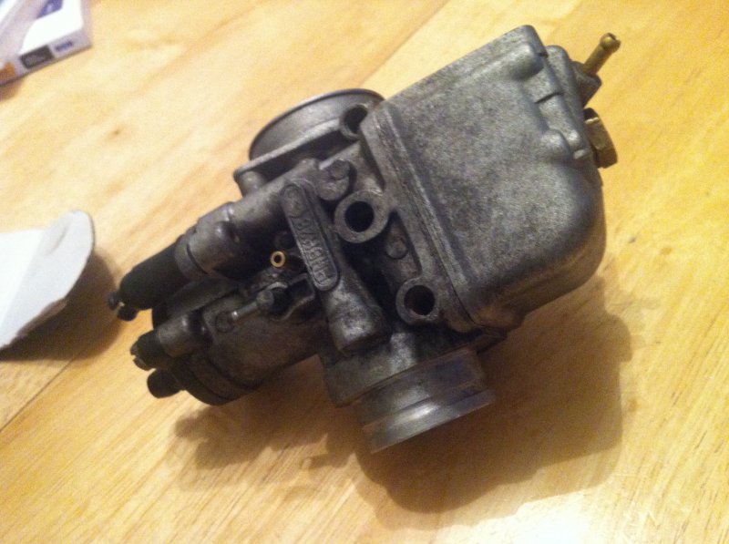

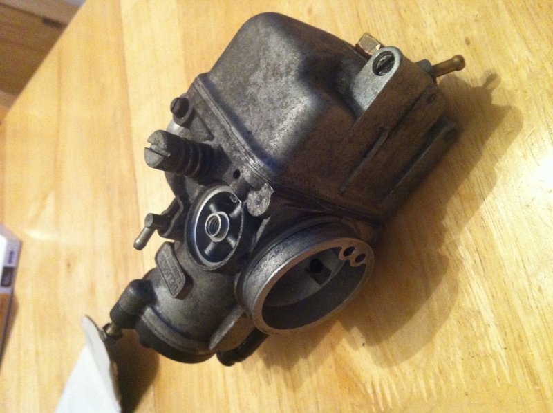

    got one of the carbs built up, but i dont know how i would attach the throttle and the choke? also theres a small brass pipe im guessing is for oil? and 2 black pipes pointing upwards, im guessing these are breathers?

    Firstly if its for anything less than a 172 id stay away tbh cos it WILL make it run shit without lots of setting up (even with IMO)
    You put the throttle cable through the bigger hole in one of those metal disc thingys then thread it through the slide and push the disc thingy all the way down to keep it in.
    The two bits either side (they dont always point up) are breathers.
    The brass bit is added after probably for oil (god knows why they put it there though id be suprised if it even does anything:confused: )
