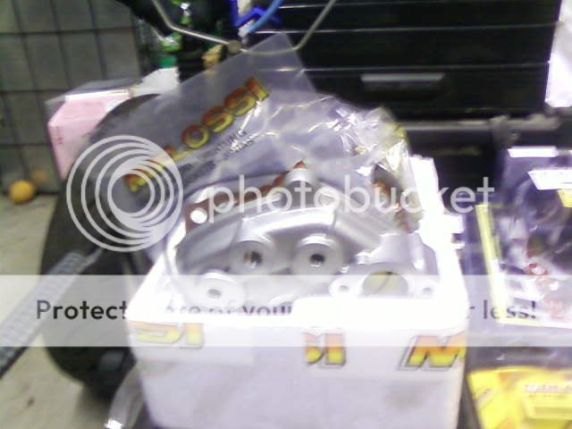

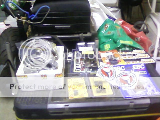

    Basically, i got given a katana lc off my dads mate as a non runner. Opened her up to find a malossi variator,belt and malossi clutch,with the intention of making it roadworthy once again. But my dad had other ideas, and wanted to make it the fastest scooter in our area, so we had a little visit to chiselspeed (top shop by the way), and waxed 350 quid in one go on a big bore kit, 19mm malossi carb and a few other little bits. Here`s a few pics of the build so far
    the bits all laid out
    malossi big bore kit

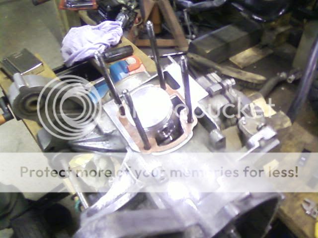

    piston on the rod

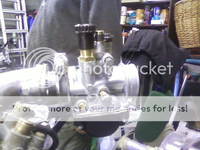

    new carb mounted on

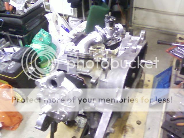

    barrel,head and carb on.
