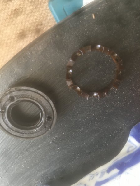

Ok I pulled out crank oil seal using screws drilled in and when it came out a crown like plastic disk which had a cup for each of eight ball bearing in the crank cane out Is this compulsory as I can’t see how you can line up the ball bearings to it without splitting thecrank open as the bearings are now bunch together with gravity
such a pain the factory bearing has poxy resin cage the ball bearing are loose and the crank sounds like a bag full of spanners on idle
Yeah, that should not have happened.... Time to split the cases.... You normally get a grinding sound long before the bearing falls apart...
