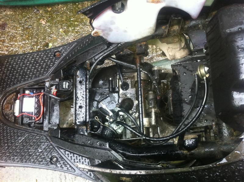

    For the carb - some photos of the installation would be good - but it sounds like a massive air leak - or no petrol getting into the bowl - for whatever reason.
    Time to get the camera out !

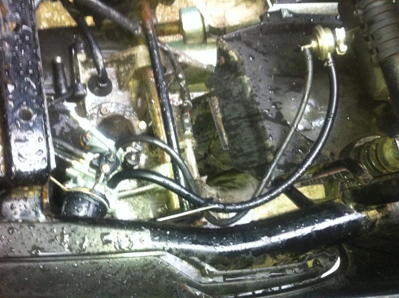

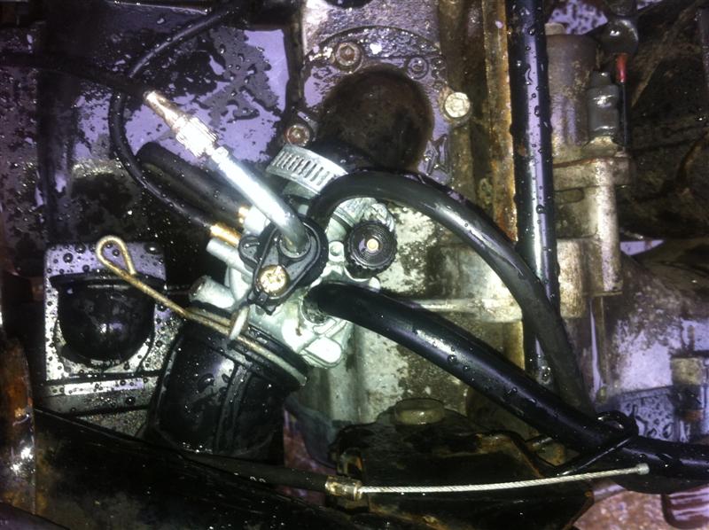

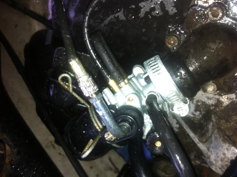

    Sorry the images are not very clear
  10. turbovetto
    turbovetto Well-Known Member
    1,561
    tweaked ovetto
    good photos man ! Can't see anything wrong at all. Looks textbook. i would have a go with compressed air on the pilot jet/ circuit. Do you open the choke when you try & start it?

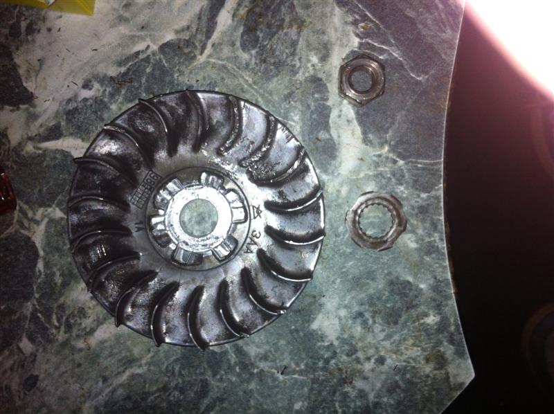

  15. Furby
    Furby Member
    41
    Yamaha Neos YN50

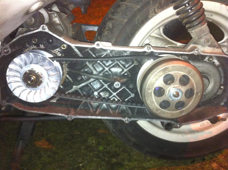

    it didnt have a washer there, its got the sleeve, variator face plate, star washer, kick start gear, large washer and nut.
    Here a pic of the first face plate after the belt snapped and the second one is after i replaced it (the belt hasnt been tighted up in the pic)

  16. turbovetto
    1,561
    tweaked ovetto
    How is your idle? Still too high as before ? irregular perhaps? Are things any better with the old carb?
    The fist pic is a mash up ! Star has disintegrated! Impressive!
    Something wasn't tight. Did you look carefully at the 'this will strip/ this will not' link ?
  17. Furby
    Furby Member
    41
    Yamaha Neos YN50
    it idles well but have always had a problem with the air screw its best at 1 1/2 turns to 2 no hesitation but it bogs and cuts as soon as i try to ride it, at 1/2 to 1 turn it runs ok but only hits 30 after bogging at 25 (fully derestricted)
    yeah did have a good look at the link you gave me and the variator was on tight before it disintegrated, is it possible for the sleeve to wear down? only got the wobble when i replaced it with the new faceplate, think i will try putting a washer or two behind it as it does sit flush with the splines instead of slightly forward.

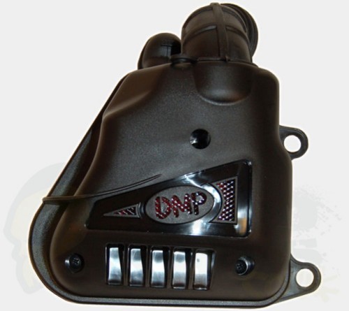

    Heres a picture of the dmp air box.
    hairyjim likes this.
