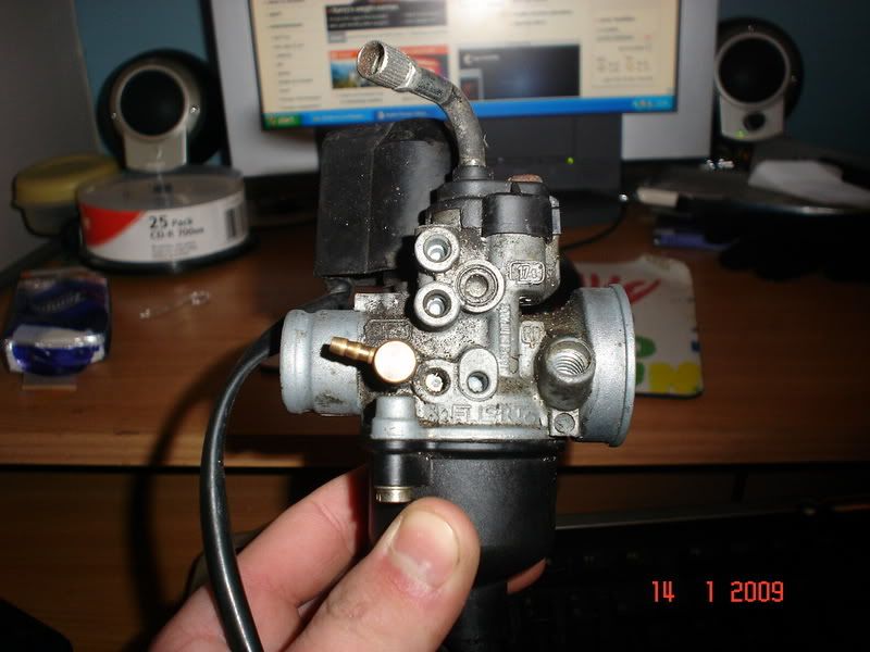

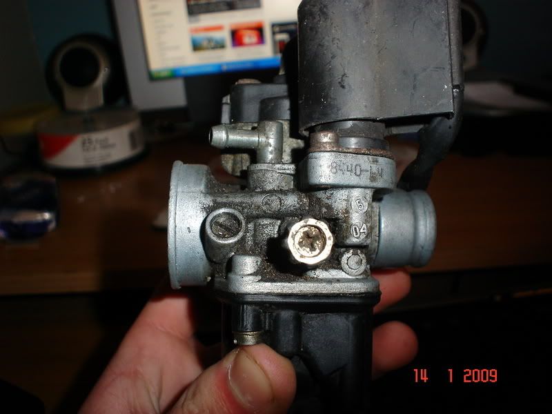

  5. Chris #101
    Chris #101 New Member
    249
    heres a pic of my delly 17.5mm and showing the 2 nipples.
    I understand what I need to do with a 'water warming pipes' I just dont get what I need to do with the vacumn pipe, petrol pipe and oil pipe? so if anyone could show me what needs to go where or what I need to buy it would be much appreciated.
    thanks
  6. billy #86
    billy #86 New Member
    1,066
    the nipple in the first pic is for your petrol pipe, the one in the second pic os for your 2 stroke, that carb dosnt have a nipple for the vaccum pipe, so youll have to get rid of the vaccum and just run a petrol tap mate

  10. Chris #101
    249
    orite cheers fellas, think il go for the tap option, seems like the easiest lol
    last question though
    so am I right in thinking that its just the case of cutting the petrol tube and putting the tap in and just block the vacumn pipe up?
