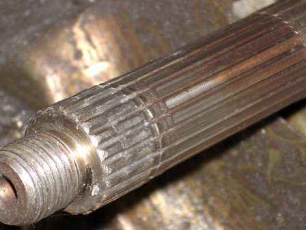

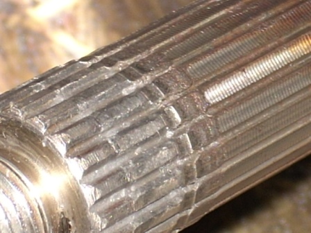

    I bought a second hand FXR180 that had had a "catastrophic event" in the transmission - I thought that most likely the variator nut had come loose and could be easily fixed. It was quite a mess. Actually had cracked the transmission case.
    After replacing the case and fitting everything back as it should (including thick and thin washers in the correct order and making sure belt was not caught) and torquing the nut to 75nm with loctite I am now finding that the bike keeps shredding the inner splines of the outer pulley. I've gone through 3 in about 2 months. The nut is not coming loose - still rock solid each time. Can't work out why this keeps happening and have pretty much retired the bike due to this. The crank splines still look ok and the bike rides ok until the pulley strips out. Any ideas what could be causing this or how to fix it?​

    however if its stripping them out id imagine the crank splines are pretty worn. a bit like fitting a new chain to old sprockets, the teeth on the sprockets will slip and kill the chain quickly

    What do you reckon?

    wouldnt have a clue, but to strip pulleys either means your buying used worn pulleys or the cranks worn and is quickly slipping inside the pulleys themselfs
