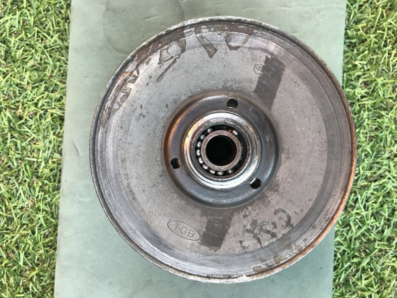

    At idle my scoot wants to start moving intermittently as if the clutch is engaging?
    What could be causing this?

    Found it. Why would this happen?

    It's a worn/broken bearing just replace it or the drum. With some bearings missing it will be wobbling causing the clutch to rub and engage.
