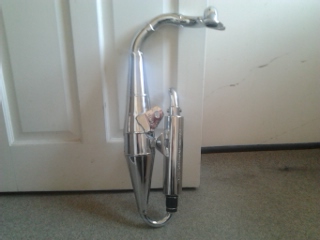

  6. Mark Emerson Trentham
    If you've got a 1 piece,this is how i'd do it-
    leave tail pipe unbunged & plug other and stand like this.,
    If you've got a re-movable tailpipe,plug downpipe +fill and stand opposite to above (upside down),tailpipe's as you please.mk. 2014-06-12 06.02.13.jpg
