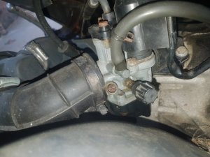

I was told that the current carb is not standard, it's also running very badly with the current one (bogging/cutting out). I attached a pic of the current one. I'm also looking to fit a 172 kit over the next few weeks so wanted to get the bike running nicely before I fit it. I have little experience tinkering with carbs and I heard somewhere that the malossi 25mm comes pre jetted for the 172 kit. Thanks for the info/advice
No carb comes "pre jetted" even new bikes need adjustment. I would do as Marsh says (he is a piaggio god!) Get that carb dialed in. Looks like a dell orto to me. Where is the problem on idle? Half throttle? Full throttle?

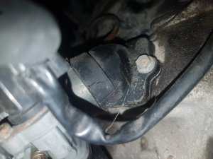

Doesn't idle well keeps changing revs and cuts out sometimes. Also there is a rough scratching sound coming from near the fan cover. Found a split in the rubber manifold, not sure if air is leaking(pic attached). Bogs when you push it past half throttle, probably only runs decent between quarter throttle and half. Basically not running well, gonna try upload a couple vids of it running later. Thanks for the advice mate
I've found that Dellorto carb's don't work for me on Typhoons, the std Mikuni work's perfect even on a 172cc, just upjet to around 90-92 on the main jet and it will work. Keeping the std pipe you'll have power from low down, all the way up !

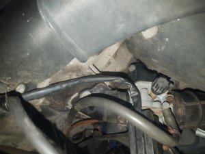

I think they're all there? "Edit - just checked again and I think it's missing one on the intake manifold?" (check pic below) but wouldn't surprised considering the state I found the fuel line (pic attached), it was leaking badly
In the third video it seems to run better after I fixed the leak and played with some screws in the carb. Hope I didn't lean it out or make it worse. Does anyone know what that rough scratching sound is? Seems to be coming from the fan area, thinking it could be a bearing or something?

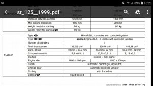

Thanks. So are you saying I should just replace the bearings or get a new crank and buy bearings seperately? The manual says the stroke is 52mm(pic below), so I'd need a crank that size right? Any recommendations for oil?
Some cranks come as a set with seals and bearings. I buy separate myself. SkF all the way! For oil either castrol or motul synthetic
