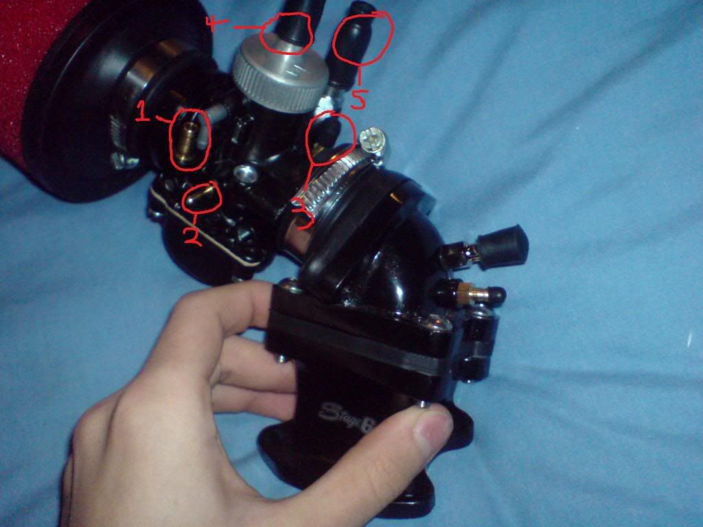

    i just got a new carb and manifold and im a bit confused what is what a little help would be nice heres some pics fella's
    much help would be apreciated thanks.
  2. kyle1b1
    first pic
    4. throttle cable
    5. choke
    1. fuel
    2. oil
    3. vacuum.
    on the senconed pic of the manifold
    they just look like another set of oil and vacuum nipples. i would use the ones on the carb and leave the 2 o the manifold blocked
  3. RY4N172
    the 2 on the manifold are for boost bottles and stuff as kyle said leave them blocked and just use the carb ones

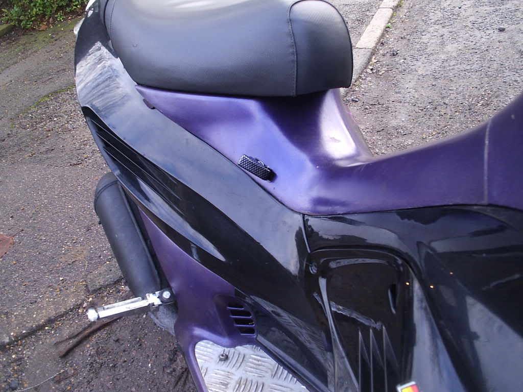

  20. rideorcollide
    rideorcollide Active Member
    2,122
    TYPH 172
    [​IMG] it sits there now, i moved the killswitch to the bars
    yh thats what i did with mine, i meant the actual cable inside as too long.. so there was too much slack, meaning that when you pull the choke it doesnt actually move the choke piston in the carb
