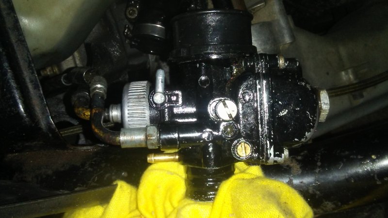

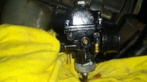

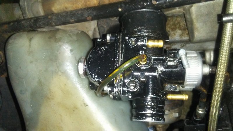

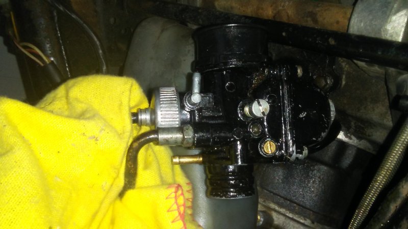

That's a Naraku carb. Takes 5mm dellorto main jets. Comes as standard with either a 70 (17mm version) or 90 (19mm version) main jet I've got several on the shelf.
I am so greatful for your replys. I have to say I'm 28 and love 2 strokes. I'm not really that new to tuning i have done two projects prior. Piaggio zip and Peugeot speed fighter with good results too. What this yamaha areox has is ( i bought it this way ) it has a tnt 50cc cylinder with a laser exhaust ( i've never heard of this brand ) with the carb in the photos. Its been running with no air filter as the original box doesnt fit the carb. There was a gap. I fixed this with some duck tape temporarily to get it going but it Splutters and kinda sounds like a miss fire but like more air pops than a typical miss fire. Compression seems okay. It will idle for ever! But if i try to ride it. It will pop and splutter without the airbox or with it and go no where The carb has a 84 main jet. If that helps sorry for the long reply.

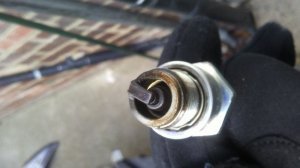

This was the spark plug. I have replaced it. But..... some how i think this is not going to solve the problem. I think I'm going to but an open air filter and up jet it. I think it's getting too much air. What size jet would you say i should start at ?
That doesn't look lean to me. Looks quite spot on, maybe a little rich really. Have you checked the compression yet. You can put a bigger jet in, but I suspect it will be worse. Get a sponge filter. Thats the best type you can use.
