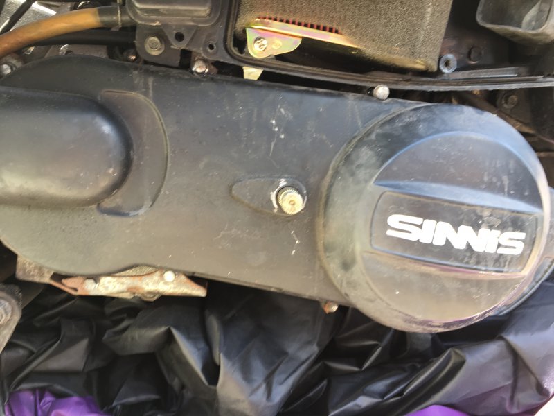

    Hi. I have a 125 Sinnis Strada. The drive belt snapped after only 3.5 years. Don't know if this is common? Anyway, I eventually managed to get the plastic cowling and the cover off. Another 30 minutes to get all the bits of the belt out.
    The annoying thing is that the kick start shaft has come out and I cannot twist it around enough to get the spring back on. Also scared I might lose a few fingers. Are there any tips to putting this back on? Don' want to ring the garage in defeat.
