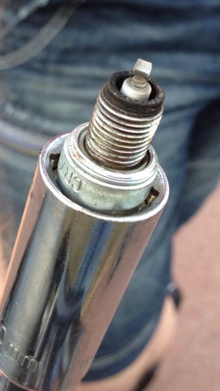

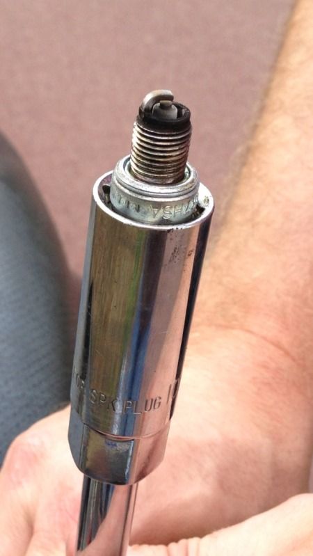

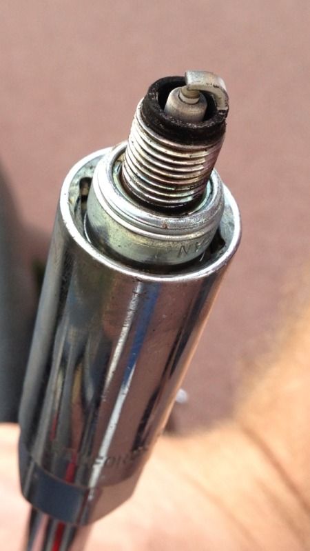

    We fitted an after market exhaust to my friends Sym Jet 4 125 as his standard one split open.
    The bike seems to run fine but we still done a couple of plug chops. I am not 100% sure if we need to swap the main jet or adjust the needle, what do you guys recon ??
    Thanks for looking :).
  2. MiNoR cOnFuSiOn
    Deffo go a lil richer. May need roller ajustment too.
  3. Neilvx
    Neilvx New Member
    22
    Vespa GTS SuperSport
    Would you think going up 1 or 2 on the main jet then ?
  4. MARSH
    MARSH Whooooo!
    3,266
    Piaggio Typhoon
    You'll know if the main jet is too big as it will cough, fart, cut out when on full throttle!
