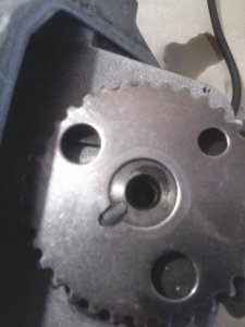

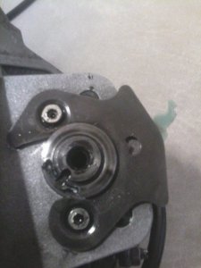

    After getting the valve timing wrong on my scarabeo 125 2002, the valves touched the piston damaging the camshaft keyway, i was going to get a new camshaft but decided to try fix the old one, i cut a slot in the cam sprocket with a dremmel, then cut and filed an m5 bolt to fit in the slot, a homemade woodruff key, thats worked so one of my scarabs is running, the other one was bangin like a outhouse door so ive laid it up, there is a good 1 mm play in the big end so it will need a crank split, also oil was leakink out the crankshaft onto the belt so a seal must have gone, will probly leave it as a winter project, will be getting the piaggio beverly on the road soon, thats a low milage stolen recovered so shouldnt need much work

    I did something similar to my tomos flywheel. I lost the woodruff so I used a hardened dremel bit cut to size.
    Sometimes you gotta think outside the box
  4. Stevep
    Bravo in your efforts Ian, however, an M5 bolt is not hard enough to be used as a woodruff key for any length of time.
  5. Ian Robinson
    Ian Robinson Member
    41
    I reckon that it is, hard is also brittle, thats why the camshaft broke, i should think that the shearing propertys of an m5 bolt are pretty high, as long as i keep the valves away from the piston, i was going to use an old dremell bit, but didnt have a cutting disk to chop one up
