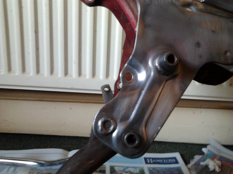

  3. Mark Emerson Trentham
    Hit a snag today.:(.,
    it'll be no problem,cleaning frame/fork shrouds/swing-arm/as i'd like......but,there is a problem with the back end sadly...the 2 wings coming off the frame/1's half to 3/4's split,so may have to resurrect old welding skills,not too sure with fixing/self due to load bearing issues coming into the picture.

    wont be long before your be painting at the rate your going.looking well nice mate.have you gotta close up of the bit that needs welding on it.
  19. Mark Emerson Trentham
  20. hairyjim
    1,229
    Got a gilera ice
    from what I can see,looks like its not that bad.if you could get it all cleaned with a glass or walnut shell media and welded up youve got a goer there.ive had worse on a few when I was a teenager and just rubbed it down and filled it with isopon and they lasted a while before it fell out..but they ain't bad..repairable..got that frame just in time before it went the way most of them go...makes me wonder why Honda ain't done something about it considering the good rep the cub range has got.good zinc dip and it wouldn't happen as fast..or a plastic liner to keep the water out of the seams..every cub in India I saw was perfect in the back..
