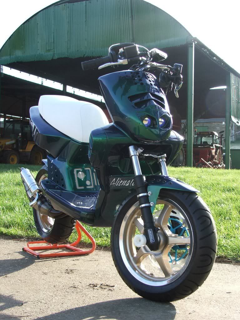

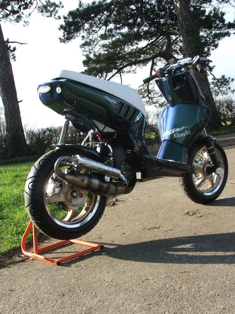

    Hi my name is sam and. Me, my brother and my dad own a scooter shop in the uk (www.boostyascoot.co.uk)
    we are going to make a custom yamaha slider but for the road
    My engine set up is going to be:
    EPC/RST tuned vertical crank case with aerox rear wheel
    Stage 6 cylinder
    Stage 6 crank
    Stage 6 teflon bearing
    Malossi over range
    Polini big vaule kit
    Yasuni R
    The custom features are going to be:
    Custom made front panle
    Custom made slide panles
    Custom under tray
    Custom cut outs

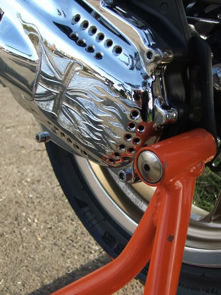

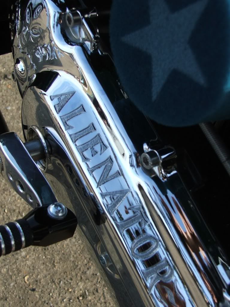

    Chroming with Custom engraveing
    Custom speed braket
    Custom foot bord panle
    Custom paint
    Aerox front forks

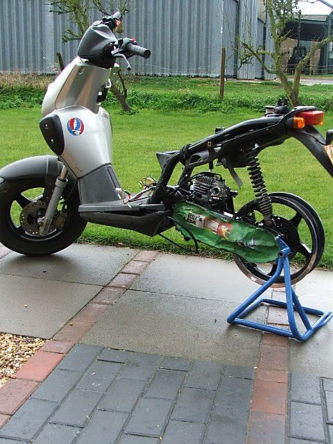

    EPC/RST engine from 2004 lelystad weekend in my slider frame
    The engine from the EPC gang has the aerox rear wheel conversion which is a very big conversion for the english scooter sence

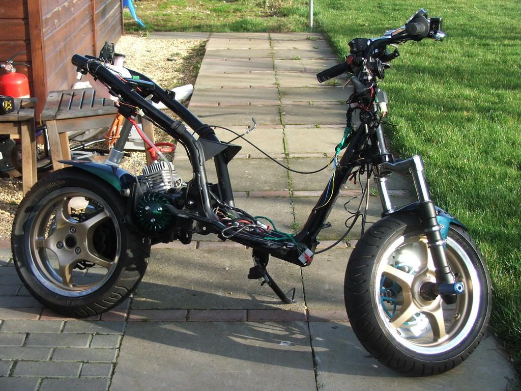

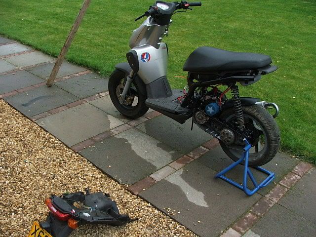

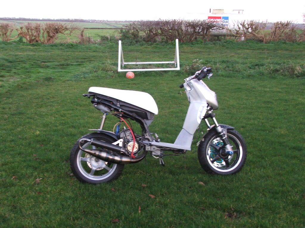

    Engine all pluged in ready for first run
    The run went well but the rollers are a bit light and we need to get the malossi delta clutch.

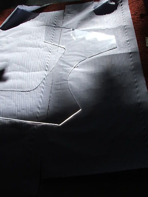

    Now i start to make the panleing look very nice
    Cut out the tempeate out of paper and then paint on
    Cut the shape out and the paint another colour to see the ruff parts

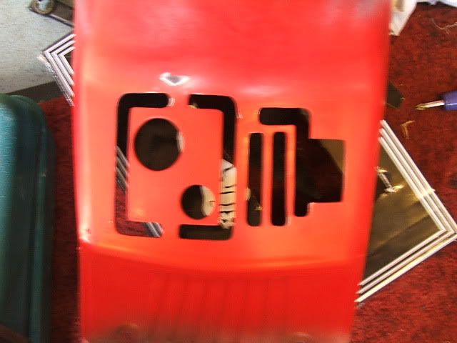

    Mark ot the holes and then drill them doing the to both sides
    Putting the tree panle into one by scoring the plastic and the fibre glassing.

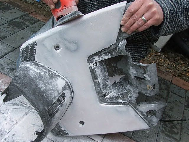

    Rub down the fibre glass and then fill to get a smooth finish. this takes lots of hours work getting it level.

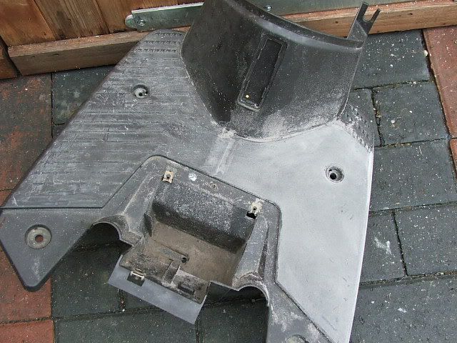

    The foot panle i rubbed the plastic out and then filled it my dad then rubbed down the filler
    The foot bord was done before the speed camera and side bits were made into one panle

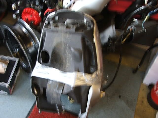

    Taped and screwed the panleing together to see what i could do to make it look better

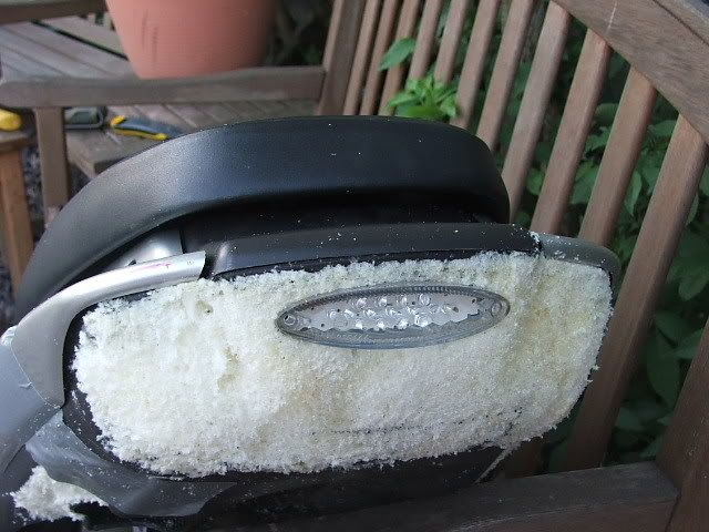

    I have put expanding foom in to fill the gap and i have then shaped it
    Fibre glass to make the back hard
    Rub down the fibre glass and then scrach the fibre galss up for the fill to stick
    Yes i know it looks messy but it id the fristy skim of fill when it rubbed down looks a lot better

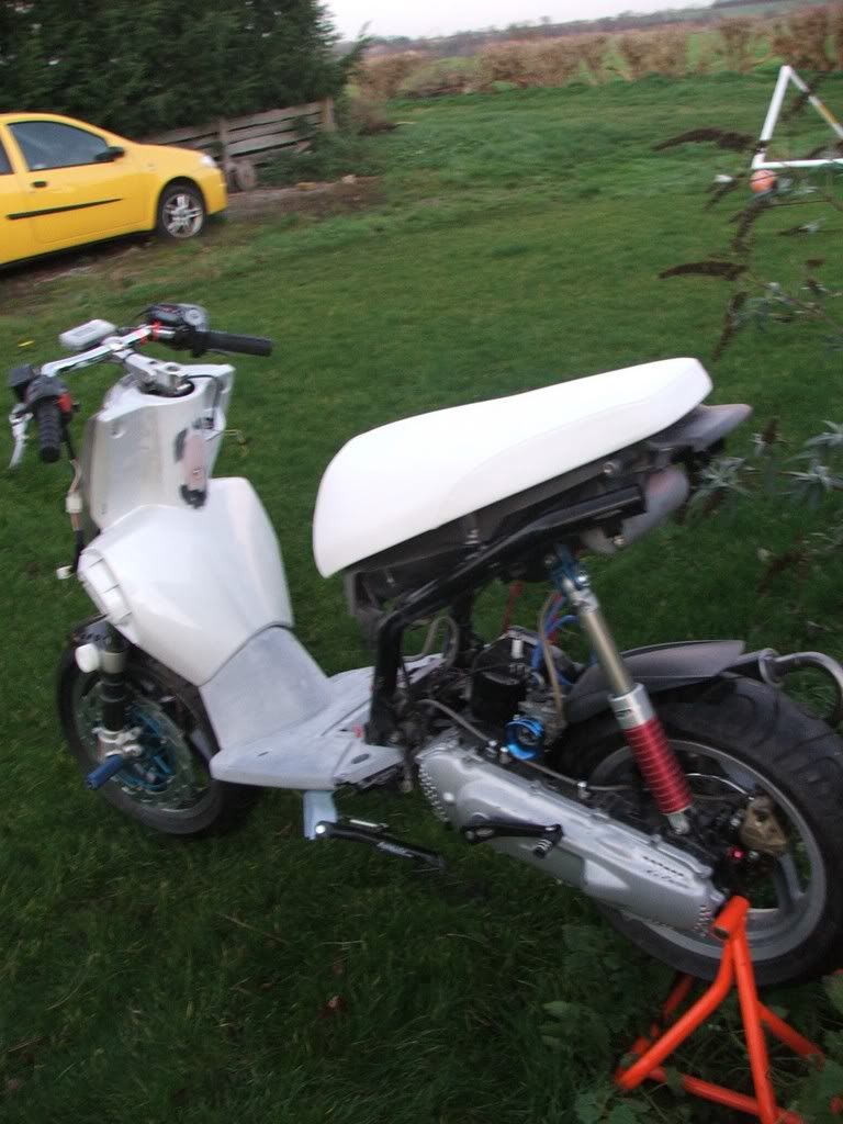

    Rubbed down and ready for frist coat of paint

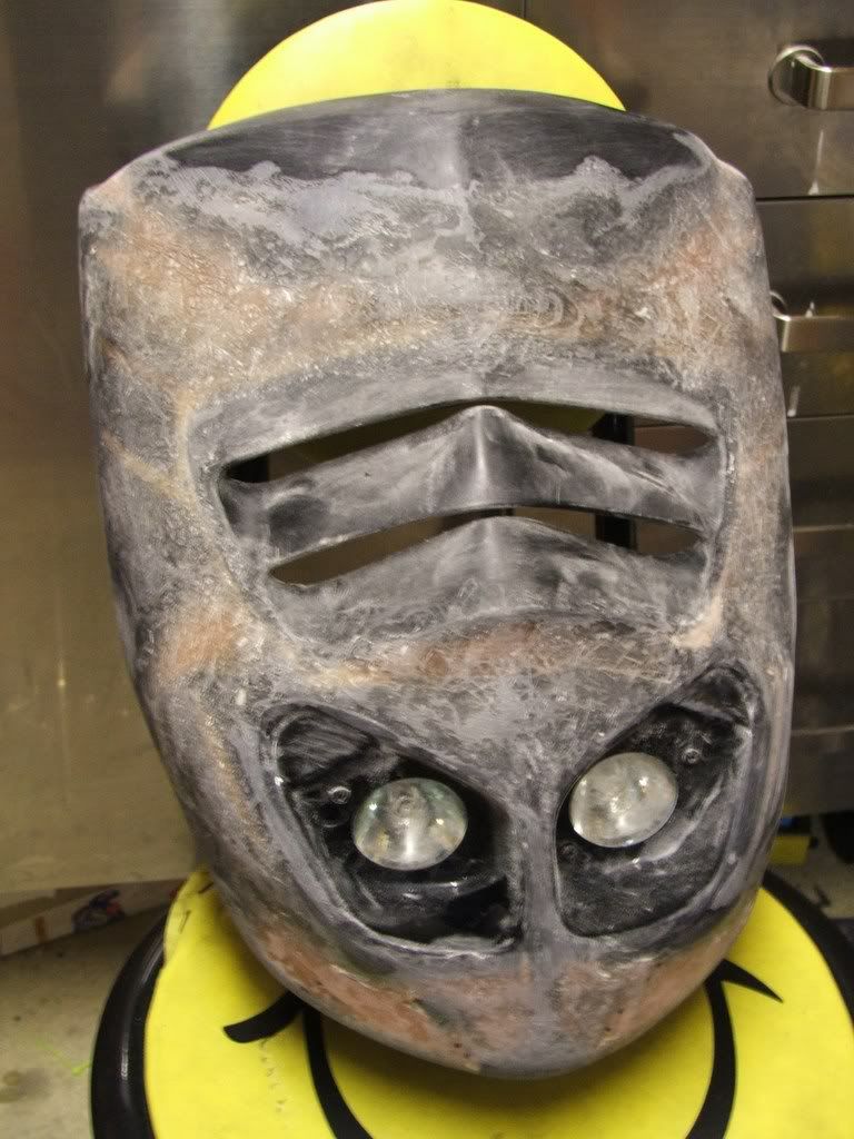

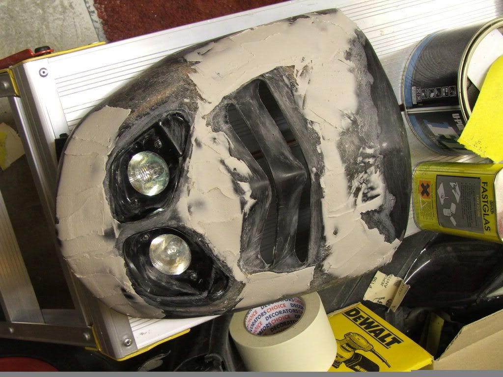

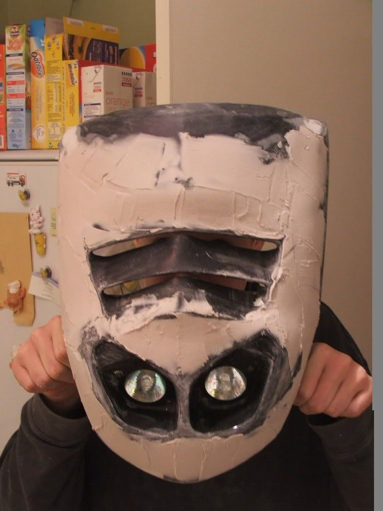

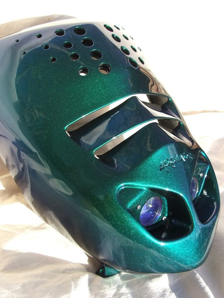

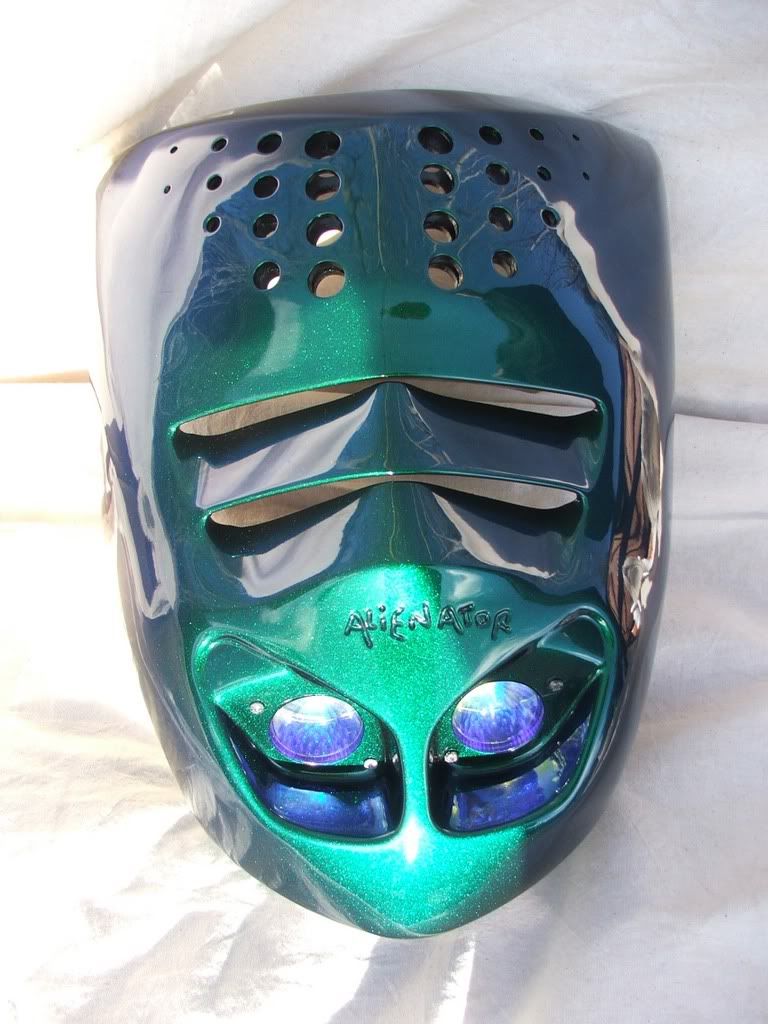

    Now i have a big panle to do this has got to look right incase it will not fit on the front of the slider
    4 in 1 there are four different panles in one
    1. TNT
    2 BCD top hump
    3.BCD head lights

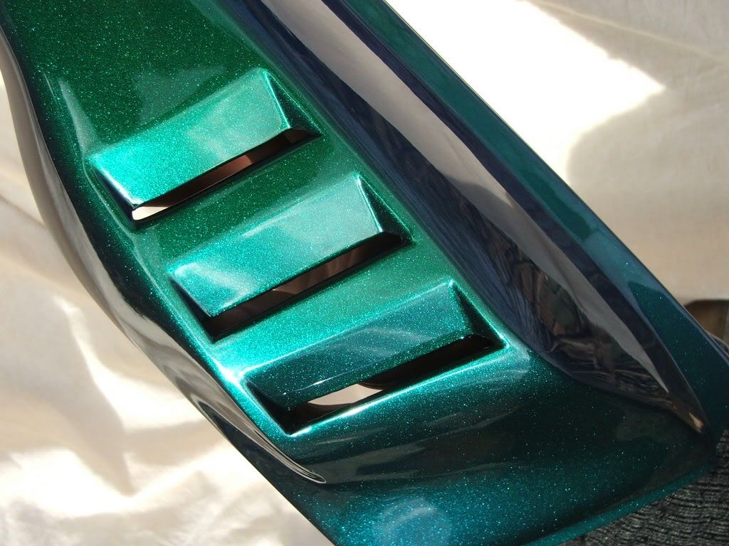

    4. custom made vent
    Frist skim of filler
    Last scim just needs rubbing down

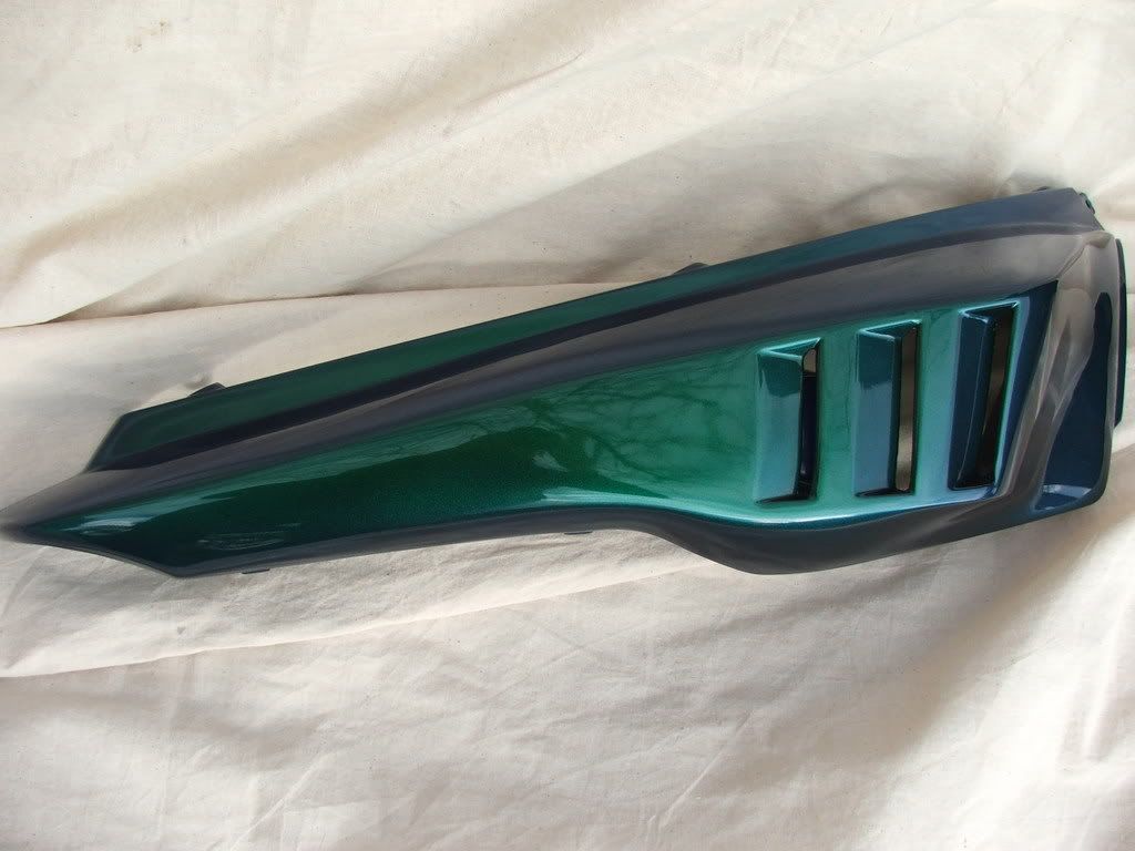

    I do not have picture of the but the side/back panle are the TNT and standard put together me and my brother liked the look of the TNT panles but not the way that they fitted so if you look at them in detail you will see that the bottom fits different
    here i start to see if every thing fitted

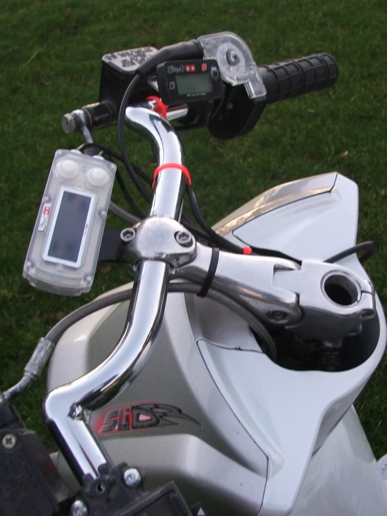

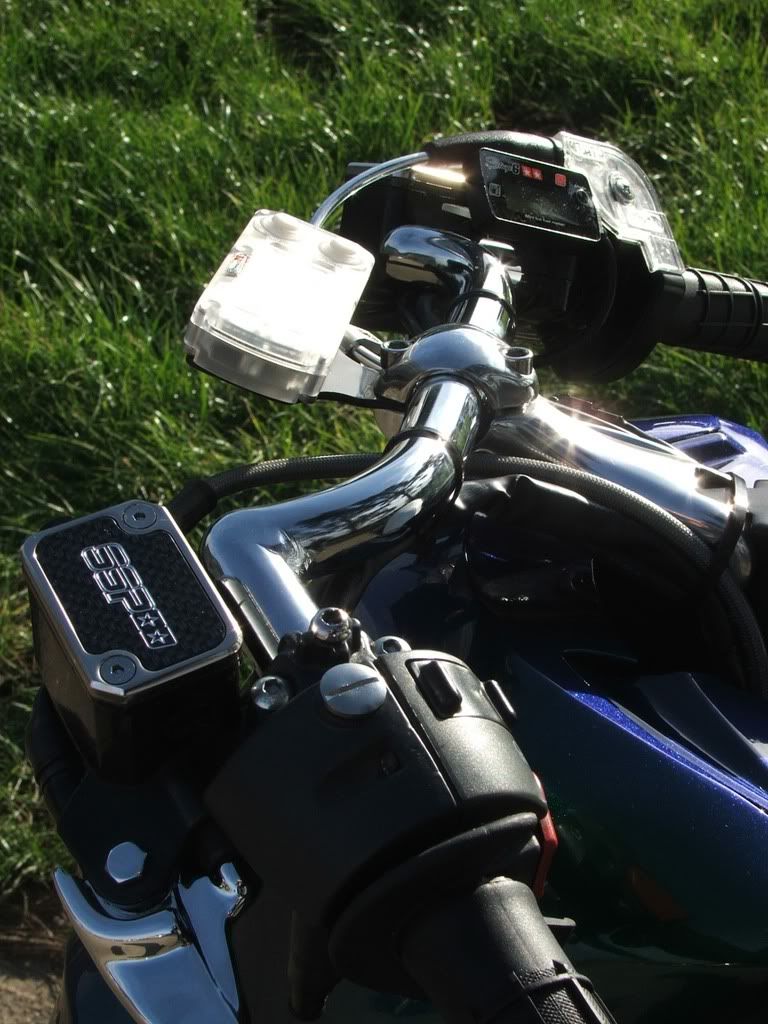

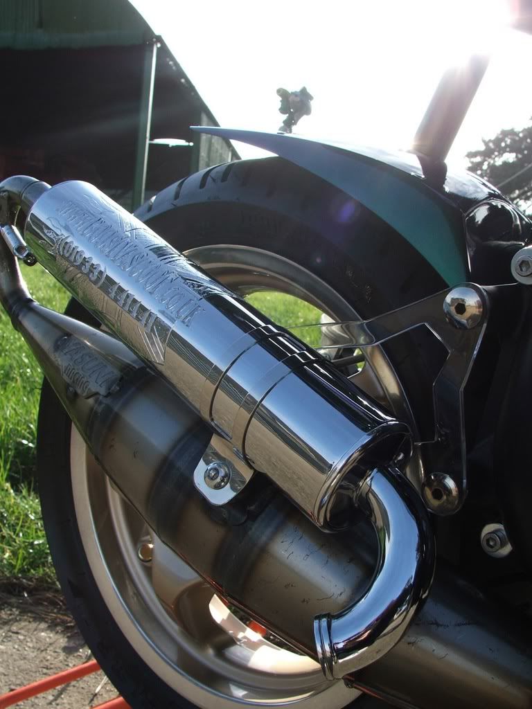

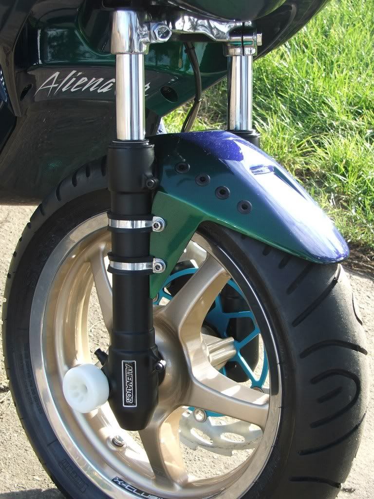

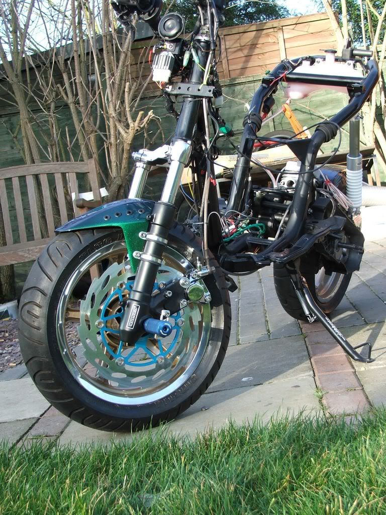

    New drop down bars now fitted and the fournales gas rear shock
    Drop down bars with home made speedo brackets

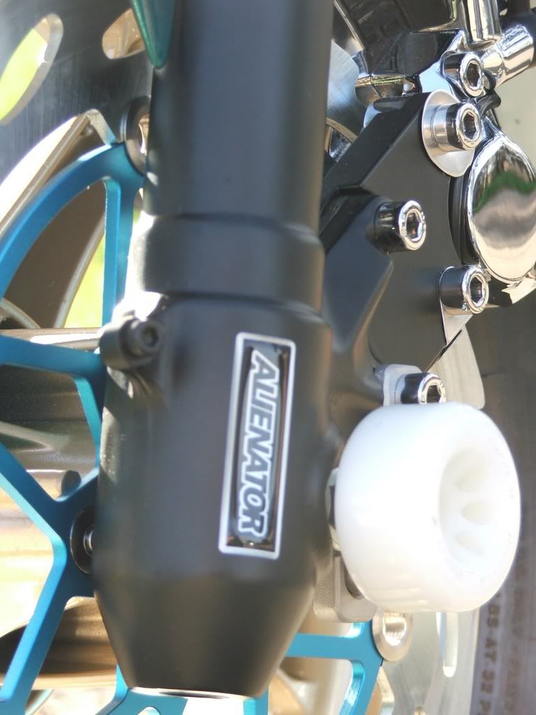

    New over sized diskon the front with the stage 6 carb mouth on the carb
    Home made clear plastic sheet for the foot panle to pertect the paint from getting screached.

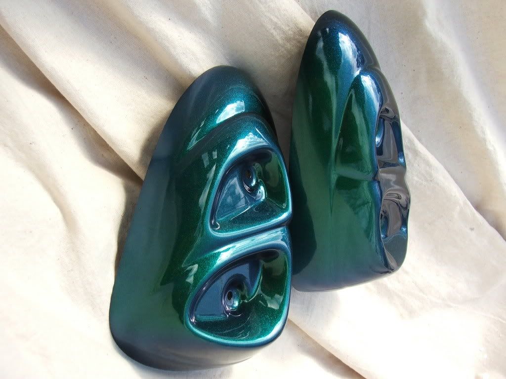

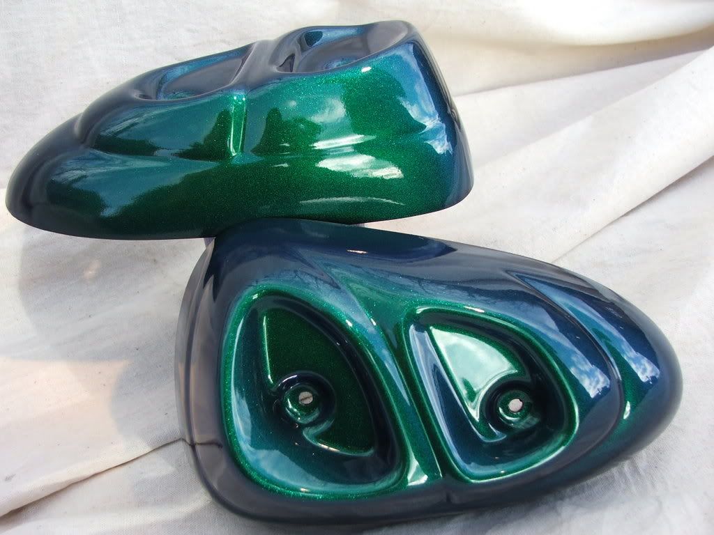

    The panle have been at the painter for about two weeks and week have got the brake calapers back from chromer

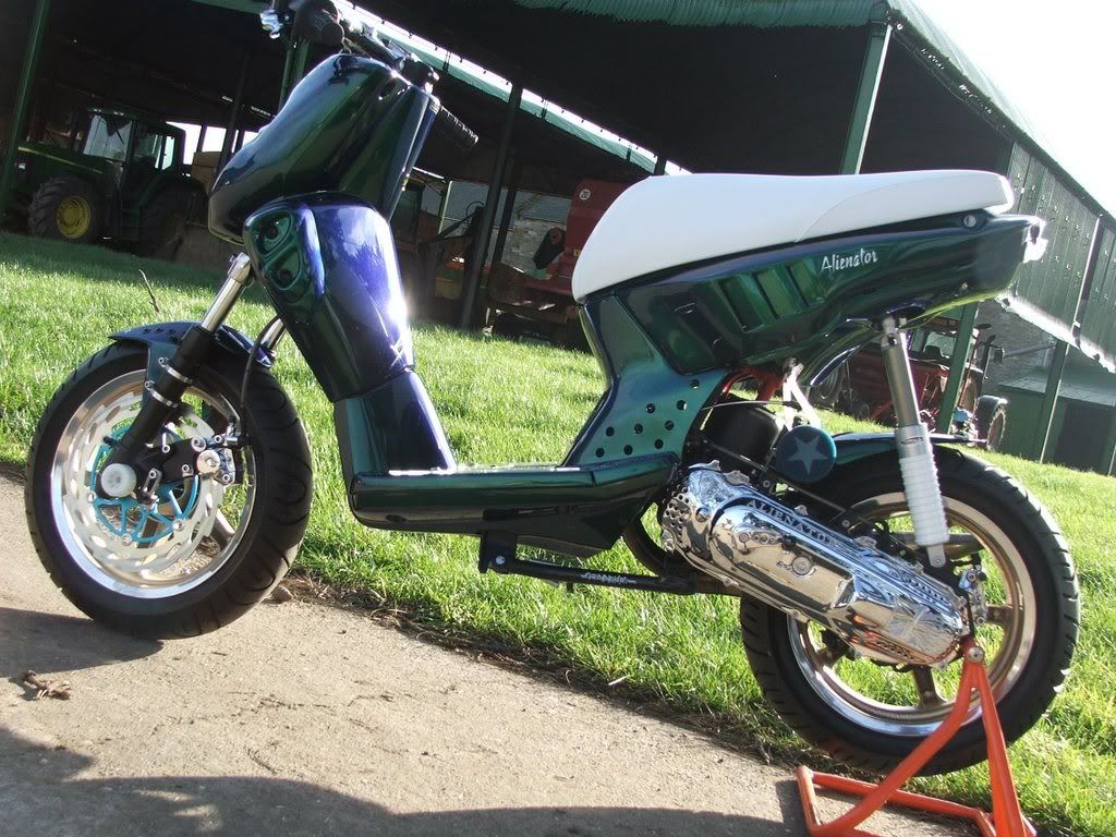

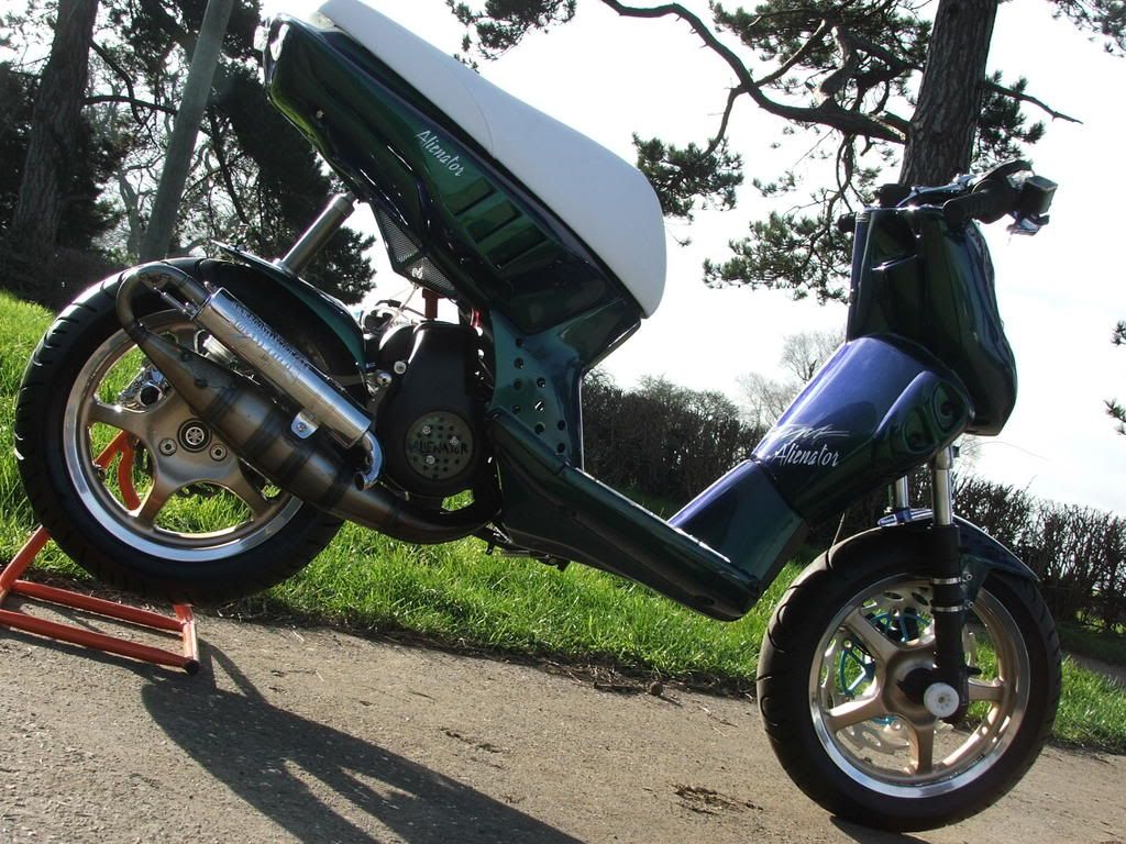

    KNOW we start rebulding it
    Me and the banker (DAD)

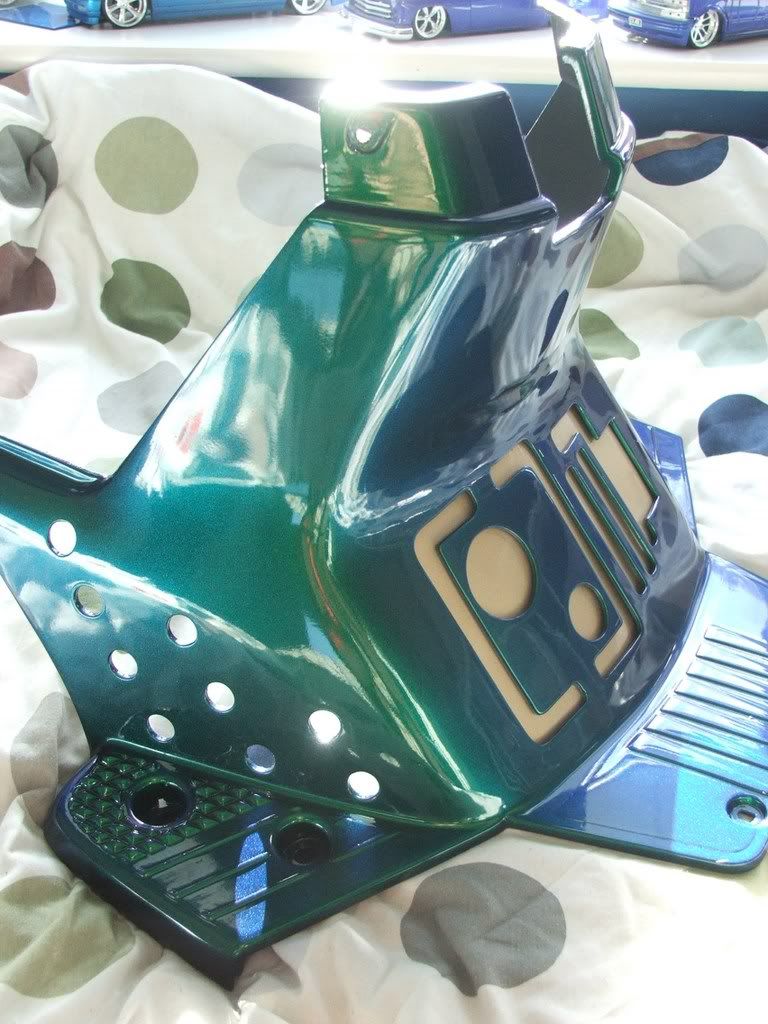

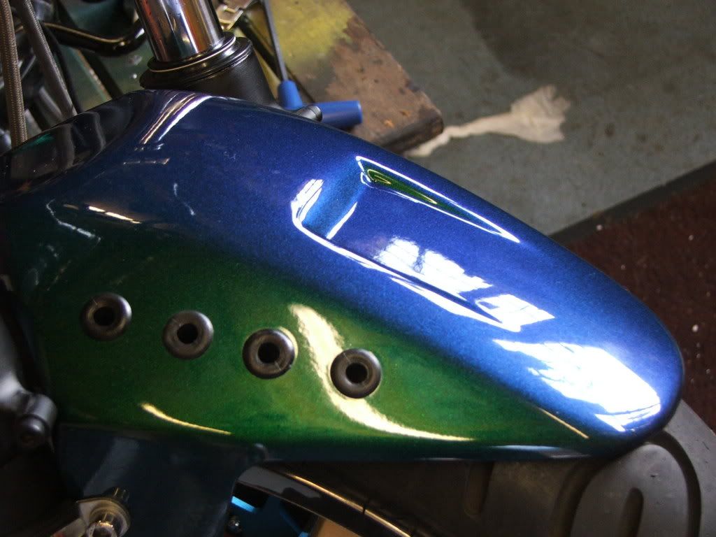

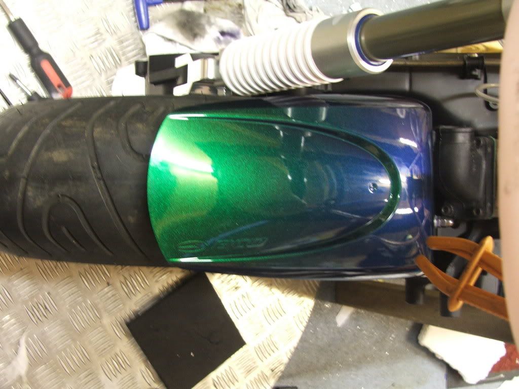

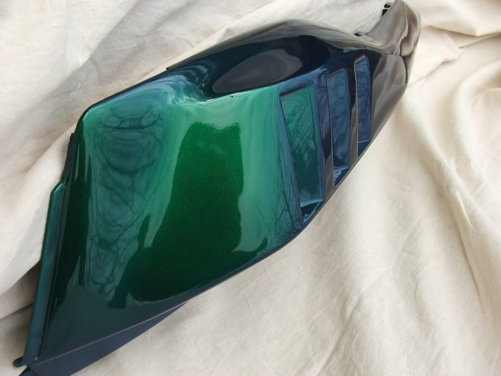

    Custom flip paint from the U.S.A
    Holes drilled in to the front mud gaurd with rubber gromets
    Here is some pictures of the paint

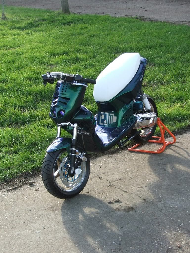

    It us about two days to rebulid the slider
