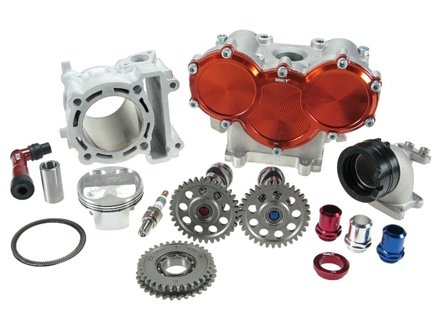

Hi there im getting my bws 125 2011 model. Any tips on how to start improving it? I found a website racingplanet with few parts not expensive thinking of using a forged 155cc naraku cilinder set, think its a smart move? Please let me know any advice its great advice
What is forged in the kit, do you recieve just a barrel and piston, or do you get a conrod etc. If the piston and conrod are included and are also forged, then no it isnt a bad move. It is a major improvement over cast components due to the forging process. Many more people will be able to help you out plenty more than i can, with many years experience under there belts.
forged rods are good, i like alloy cylinders and pistons, you can get pistons with all sorts of base materials. naraku are good kits for the money, budget but nice. does the bws have FI or is it carb? if its FI you will need to remap the ECU and fitting a bore kit will be useless. its worth maybe just getting a hot cam and straigh pipe. http://motogaga.com/ will probably have parts at a guess...
On the Naraku kit Macc94 mention it's the piston which is forged Those Naraku kit aren't too bad I run one on my agility it s fairly quick but limited by the transmission now I need longer gears but that doesn't exist !!! The Naraku kit come with two option forged or cast piston cast being cheaper the forged like all forged piston engine is noisier and will need good warm up time the cylinder is cast aluminium alloy not sure of the skirt treatment chrome or nickasil On those engine to replace the rods you have to split the crankshaft so better change the all crankshaft if need be it is normally strong enough I have the 170 on mine and the bottom end havent moved even tho it s always high revs due to the original transmission Stay away from anything electronic with Naraku as it s not good I had a supposed to be high perf ignition coil which was sparking all over the place but the spark plug and the CDI never worked neither I also fitted the 30 mm Naraku racing it wasn't a straight fit I had to modify many things and raise the supposed to be inlet manifold meant for this carburetor This look really really sexy but oh soooo expensive !!!!!
