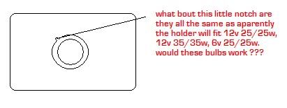

    what bout the little notch heres a diagram [​IMG]

  7. ramo
    ramo GoldMember
    1,572
    As long as the notch is in the same place in relation to the pickups on the bottom of the bulb it should be fine. Id check though as some models of scooter use slight variations for some odd reason. If not you can modify the holders a bit but this can be a pain in the arse
