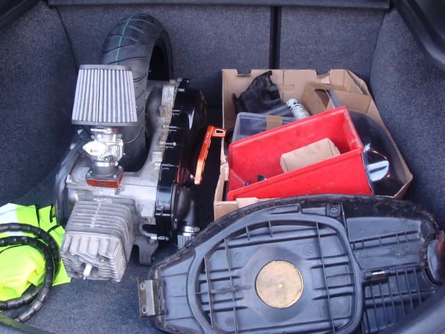

    i was under the impression there was no gains in opening the boost port feed like that. or is this a cylinder conversion?
    im preaty sure its better not to have curved transfer feeds (like in the corners they should be more angular) im not exactly sure on it but i have nevver seen anyone not do this to a barrel.
    is that a bgm 110 rod 55mm stroke crank?? or something crazy like 57mm?

    looks tidy as fuck.... wheres the reedblock pics? sommin differents going on there from what i can see LOL
    boost port (andy) is down to the reedblock i find... boost port entry is never a bad thing, just most cases increasing its size decreases flow and kills the entry angle.. this looks well nice tho.
    as for angular transfers..... the point is to achieve a constant movment of air ie it keeps on in one direction in a narrowing path gaining speed, if it changes direction it needs to be a constant. alot of cases you see its verry angular but the main idea is for the air to move in circular motions, long sweeping curvs, if done correctly the air should flow in prittymuch a perfect circle from the transfer feed to the piston.
    but ye, more pics please... can guess who's done it ;) ;)

    New Malossi 172, road-race tune by MRBee

    come on, less sneeky, lets see the reedblock and exhaust port :D

    Yes thats a 34mm carb :cheers: ill post up a full project log upto now later on when ive done a few bits

    ie the correct size for a ported 172..... drinker but the BEST performance is found wiht a 34 ;)
