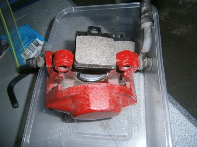

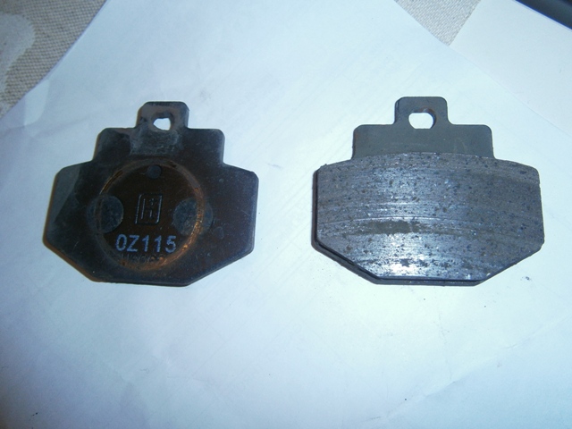

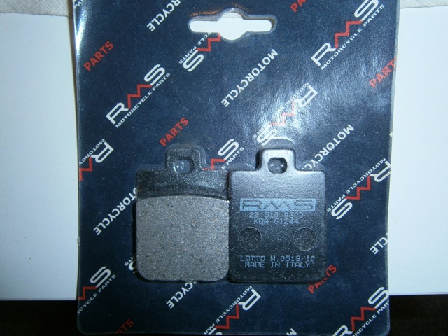

    My rear brakes have never worked very well and I finally got around to changing the pads. Here is a picture of the ones that came out. They appear quite different to the replacement ones. I cannot find any pictures of pads on the internet that look the ones that came out although all of the replacement ones do appear quite small to me. Has anyone seen this style of pads for the runner? Perhaps they were the wrong ones?

    It look's like you have a later rear caliper, gt/gts/vx.

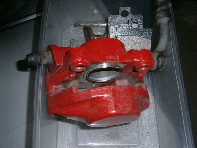

    Really.. that's weird. I attached a couple of photos of the caliper if it helps.

    It could be the vx 4t runner caliper, the little pads are 2t runner for sure.
