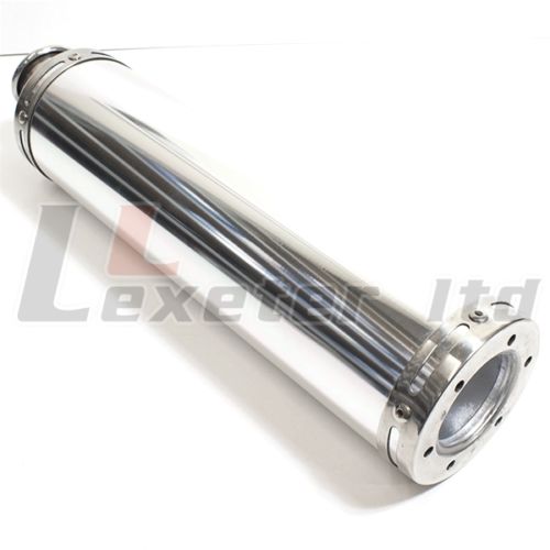

Alright lads bought a sports exhaust for me gy6 chinky clone the other day but I've got no power. I upjeted from a 110 to a 115 and I'm running on stock air filter. Any ideas why I've go no power? It's sounds great but rides crap. Also the Exhaust is completely sealed and its all brand new including gaskets& a Brand new cylinder head. (Snapped me old exhaust stud and had to replace as I couldn't get the snapped stud out)

m looks like the same as I've got on my chink..same place as mine too.made my chink 50 sound like a much bigger bike....
