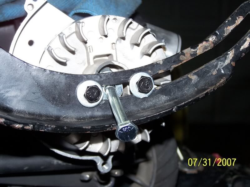

    did you get the flywheel off yet????
    if you don't have the proper puller...you need a bit of 6mm plate about the same size as the flywheel
    drill and tap M8 hole in the centre and then set out the threaded holes in the existing flywheel on the same PDC. Bolt the plate to the flywheel with those holes and then wind in the M8 bolt onto the crank end
    a bit like this but thread the centre hole (found the pic on the net)
    hope it helps
