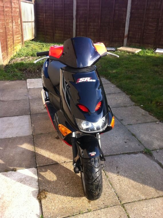

    My sr125 hasn't run for three years has been in storage on a trickle charger , so picked it up and rode it to MOT it passed fine and rode it home.
    Now it doesn't idle very well but still runs just want to get it all running smooth , so I'm thinking
    1- drain fuel tank refill with new fuel
    2- clean carb
    3- check / replace air filter maybe clean it ?
    Wondering if there is any other procedures I would be best to carry out
    Also how do I check the transmission fluid level and what fluid does it take or even drain and refill ?
    I have no manual for the bike
    Its a 2000 aprilia ar125 2t ac
    Thanks for any help guys I'm all new to this !

    Thanks for the comments guys it is MINT , only done around 4000miles ! , i went to do the carb but found the inlet manifold rubber was split so will need this changing and found my engine mounts are stuffed have side to side movement but will put a new post up for that to get it more widely answered .,
    also would you go for a NGK or a NGK iridium ?
    oh and what PSI in the rubber guys ?
    to the first comment its a 125 not a 50 .:)
