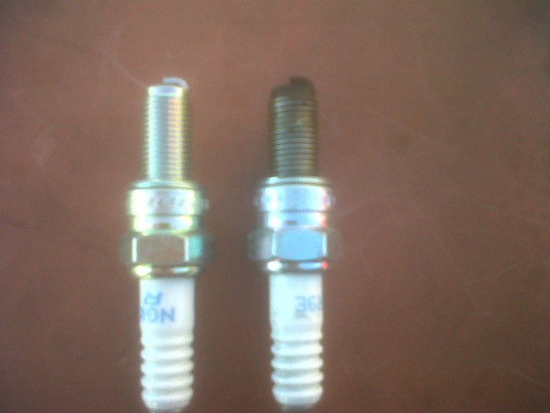

    Yeap... Spark plug was gubbed.
  8. Jonathan123321
    Jonathan123321 Member
    244
    Piaggio NRG Power DD
    If it is struggling to start make sure your battery is fully charged and That NEW Plug you have there is to long. It sounds to me that u need a new engine

    Sorry spark plug is fine my pc didnt load the pic properly :)
