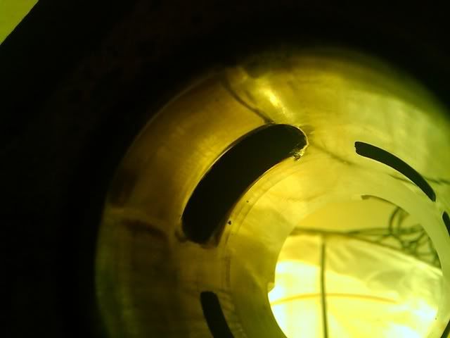

    Right. took my top end off earlier to find this
    Big fat score in my barrell. but the rest of it seems fine no scores or nothing and my rings and piston look like new
    Would this be why my bike isnt starting though?

    You checked fuel but did you check for a spark?
    There were so many other things to check before taking topend off :cray:

    It was a little extreme to jump too, but that barrel is scrap anyway so it needs replacing.
    Im sure a post in the wanted section will turn up a cheap barrel if ya need one in a hurry, i might even have a malossi 70 air cooled barrel kit somewhere?? Ill take a look.
