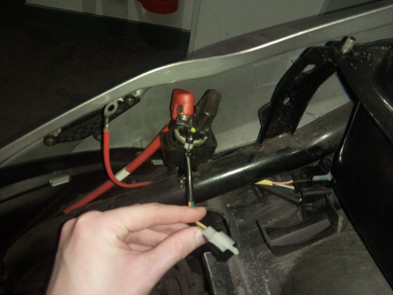

Never mind, I got it going. I reconnected the solenoid but only connected the red and black cables and not that 3rd weird connector cable and it worked. Can you explain to me how those 3 cables work and why it didn't work with the solenoid removed? Also made it home fine, no issues once I stopped and turned the bike off.

So back on topic, any idea why the bike wouldnt come alive when i completely removed the solenoid and only came back after connecting the red and black wire to the solenoid? Im assuming the red and black cable are from the battery and the connector coming out the bottom of the solenoid leads to the starter motor? Im trying to understand the electrics a bit better.
It was probably the earth cable needed reattaching. Try taking off the red live cable and see if it still works or if not the other way round.
Its like this: Battery has 2 leads + and - the plus goes to the starter relay then splits off. You disconnect the whole relay and you have no electrics, disconnect just the lead to the starter and you still have electrics.
Can anyone tell me what each of these cables leads to. I'm certain the thick red and black cable are directly from the battery but then there's a thin red wire that I can't identify and when disconnected the bike is lifeless as I just tried so what does that do? I assume the cable connector at the bottom is what leads to the starter motor?
Goes to ignition switch?? The connector is probably from your starter button to operate the solenoid.
