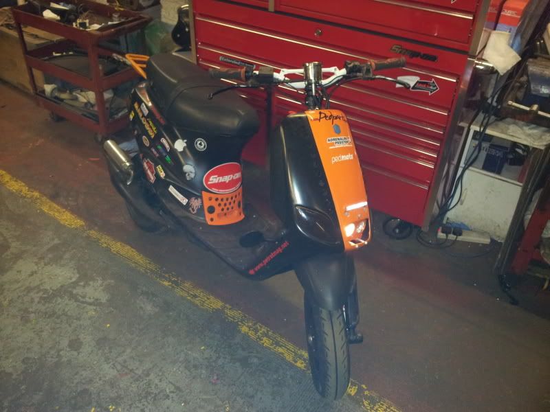

    Ok so its been a while, but ive finally done it.
    Sfera 80cc front end fits straight into a '99 and earlier zip. A 17mm Alu billet home made spacer had to be made so that the top steering bearings were loaded as there is that amount of difference in length between the zip frame and the Sfera fork tube.
    I had to fit a bar conversion and universal speedo as the original clocks bolted to the bars simply didnt cut it... Ill do a full picture thread later...
    http://i52.photobucket.com/albums/g17/calibrakid/FB_IMG_13485122433537455_zpseb087171.jpg
  8. Burridge
    600
    MZ TS125 #swag
    Looks nice man! Great job :D
  9. typhoon1234
    typhoon1234 Member
    232
    Yea looks nice...a show piece u have there
