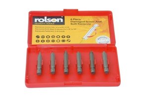

    Yeah probs the best way to take to garage seen some drill bits that say they take them out but not sure

    Yey rolson! There's a brand you don't trust, they used to make zippo style lighters back in the day, now they supply all sorts of shit, I got a rolson rope and a couple of slide knives, I think they supply tesco with there cheap packet of random stuff too, 10x pack of super glue etc etc, yeah take to a garage buddy
