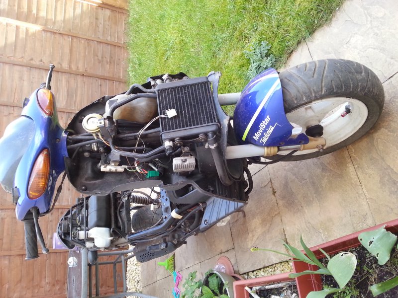

  4. Livefast
    Livefast New Member
    8
  5. Stevep
    That rear tyre looks a bit skinny, profile wise. Should be a 120/70/12
    And it's got the battery cover as well, thats normally something thats missing.
    Stick a photo up of the other side, lets have a look at the speedo drive please. The early ones were different and tended to sieze due to road grime and snap the lugs off.
    You're quite right about taking the lump out, rear shock bolt, front mount bolt, cables and hoses. Bear in mind you will have to support the bike very securely, because the stand is attached to the engine, not the frame.
    Yay, i've just noticed it has the flashes in the rear wing as well, something else that is sometimes missing.
    If you ever get the urge to take that apart, to paint it for instance, resist at all costs. The flashes are glued in place, and the 4 screws that hold the wing together are behind them.
    I've already done one of these and i'm now on the later model, here's the link if you fancy a read.
    http://www.scootershack.co.uk/threa...-ill-never-know-katana-ay50wrw-project.30879/

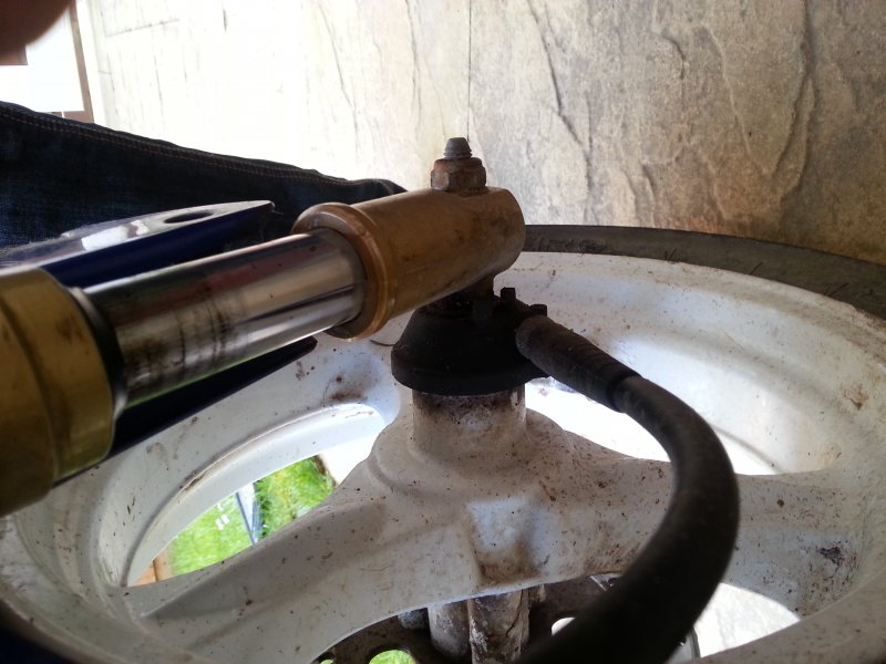

    Here is the other side of bike
  7. Livefast
    Livefast New Member
    8
  8. Stevep
    great, thats the later model speedo drive, means the front wheel has been changed as well, they are a damn site easier to get hold off.
