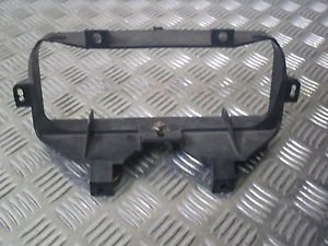

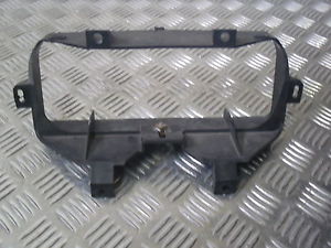

i was to fiberglass over some alloy mesh into a strip, then mount this to the underside of the sym jets plastic headlamp cage. use a couple small fiberglassed alloy mesh plates on the inner side to spread any force and stop it splitting , then mount the lamps to the end sections of the fiberglassed strip. i could fabric it to go the whole width of the front panel and have a few drilled holes for mounting points so can get them lined up perfect. i also thought about removing the front panel and headlamp holder cage and glassing the whole thing with an added layering of alloy mesh , then adding the alloy'd mesh strip to the bottom , double the strength of the current plastic holder and add meat to secure the strip and lamps on the ends. Image of the headlamp cage added
Going through manual to see where some suitable metal lugs are i could maybe run a couple of mounts from. if i take a tumble and they are fork mounted i can see them getting mashed up, plastics are 10yr old so not a supple as they used to be and prone to cracking easy ( some one tried to screwdriver my front indicator off, mashed up the lens unit and snapped my upper bar cover). not enough freespace ontop of mud fender i would hook up on the front fairing when forks compress. still looking for some mini lamps , but also saving pennys to try get new bike with better headlamps
