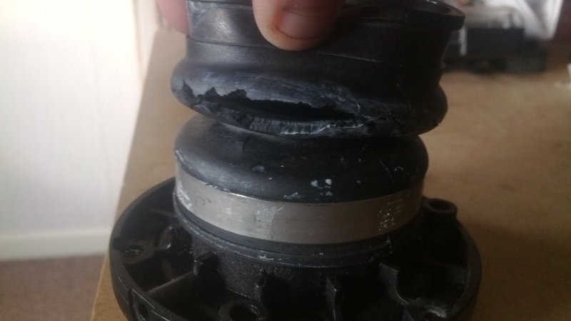

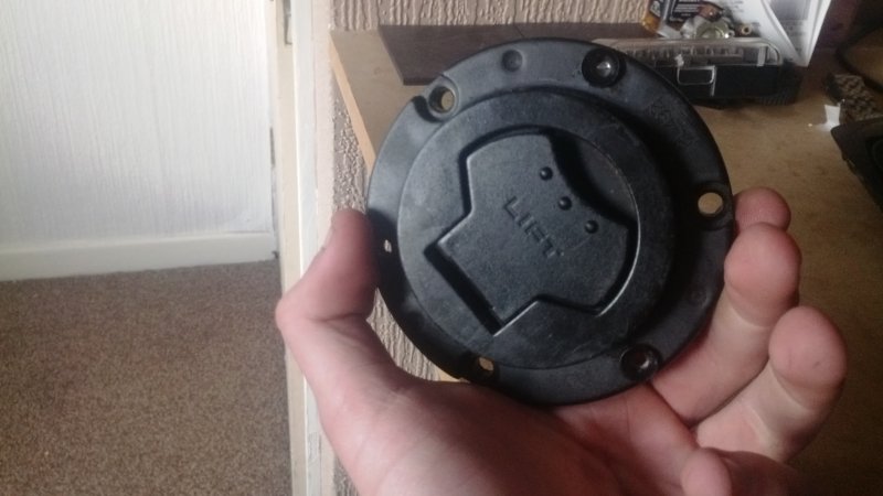

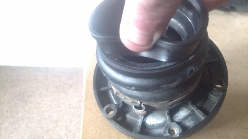

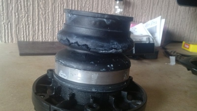

    Uhm well i have actually had a similar problem and after spending over £400 pounds on parts ive found the problem :confused: The Piece of rubber that joins the petrol cap to the tank had a MASSIVE split in it. In turn reducing the fuel flow to the carb hence the cutting out. give me 20 mins and i will upload some pics of it. You never know you might have the same problem :L

    So after all the money - THIS was my problem :L

    thanks for that mate but it don't think this it the problem as I have already drained, clean and reconnected all the fuel system as I through there may be a fuel blockage but there was not and every thing was running fine. Anyway I think may be a problem with my rollers . I will take a look at them tomorrow .
