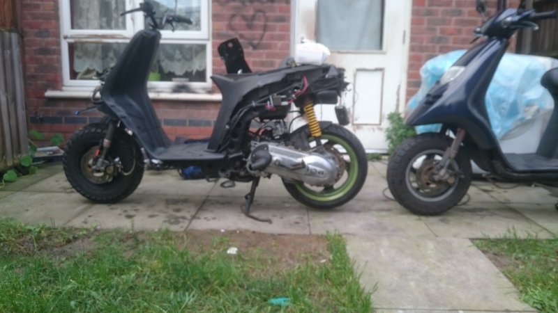

    My friend said my forks look bent gna swap with my other typhoon

    Yes they do look bent, you'll need to check frame as well, measure it against the other typhoon, measure from top bearing to where the seat bucket bolt's down to the frame or a good area.

    Alright im gonna measure it because I have had a crash on it before then I'll switch forks if the frames good
