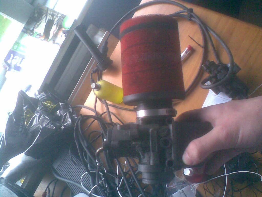

    got my 28mil carb
    and renthals

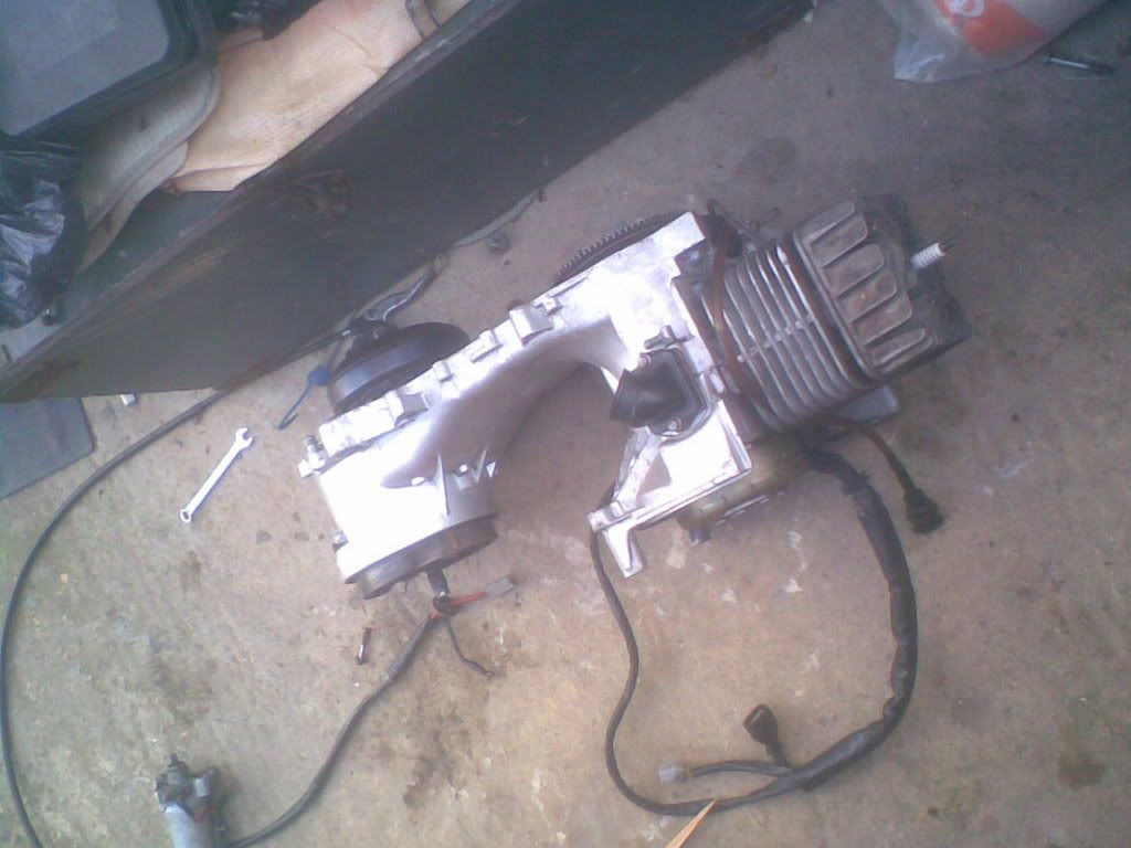

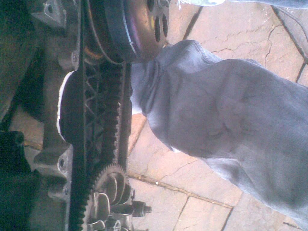

    the engine
    i had trouble getting the nut holding the wheel on off even tried using abit of scaffolding bar and managed 2 bend the wrench :(
    wheeled engine to the garrage to let them have a go with an impach wrench took them about 5 seconds :wtf: anyways took it home and gave it a little scrup with a wire brush and some soapy water
    that was taken just after the first round with the wire brush its actualy alot better now...still not gr8 but alot better

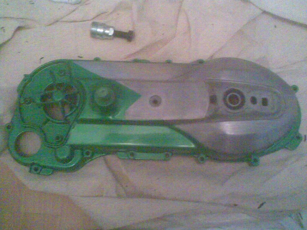

    after abit more polishing
    update

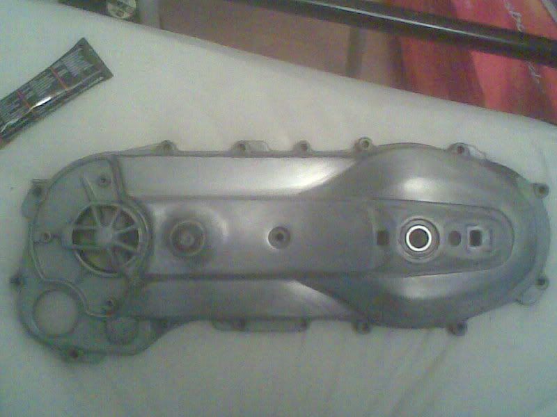

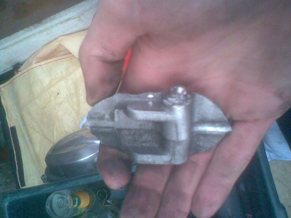

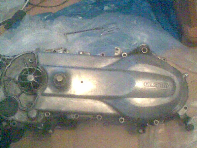

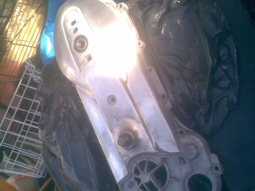

    was taking bolts off kickstart case and found out most of them had been rounded by a previous owner managed 2 get all but 2 out and then cut and hammerd 1 out and started on the last. i tried levering the case off and well it went horribly rong
    the bolt managed to stay in....ut the cases managed to snap
    update

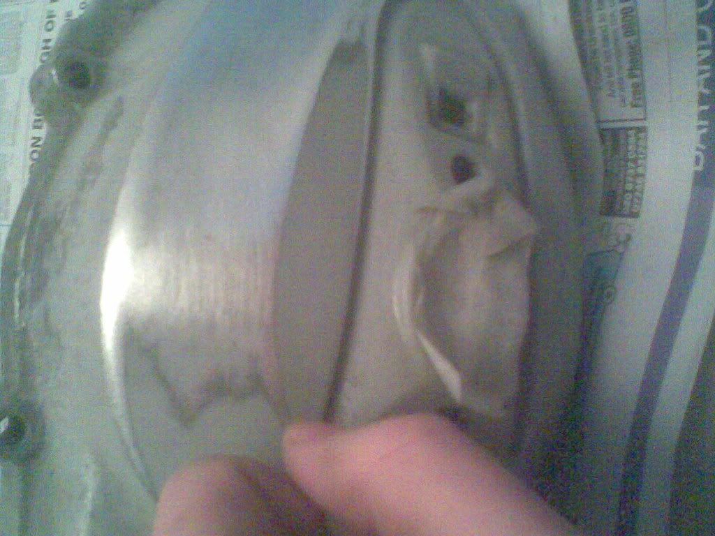

    got my new engine here sunday night and have been sanding it slowly since lol just finished 2night
    and heres what the inside looks like

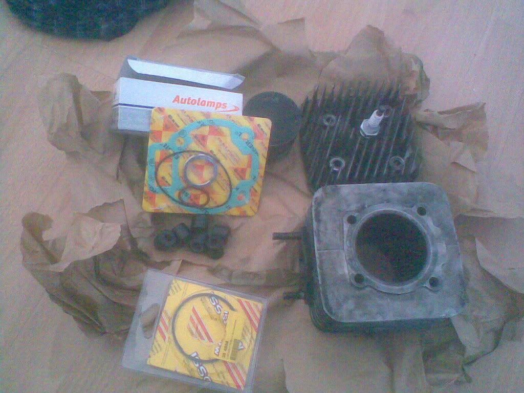

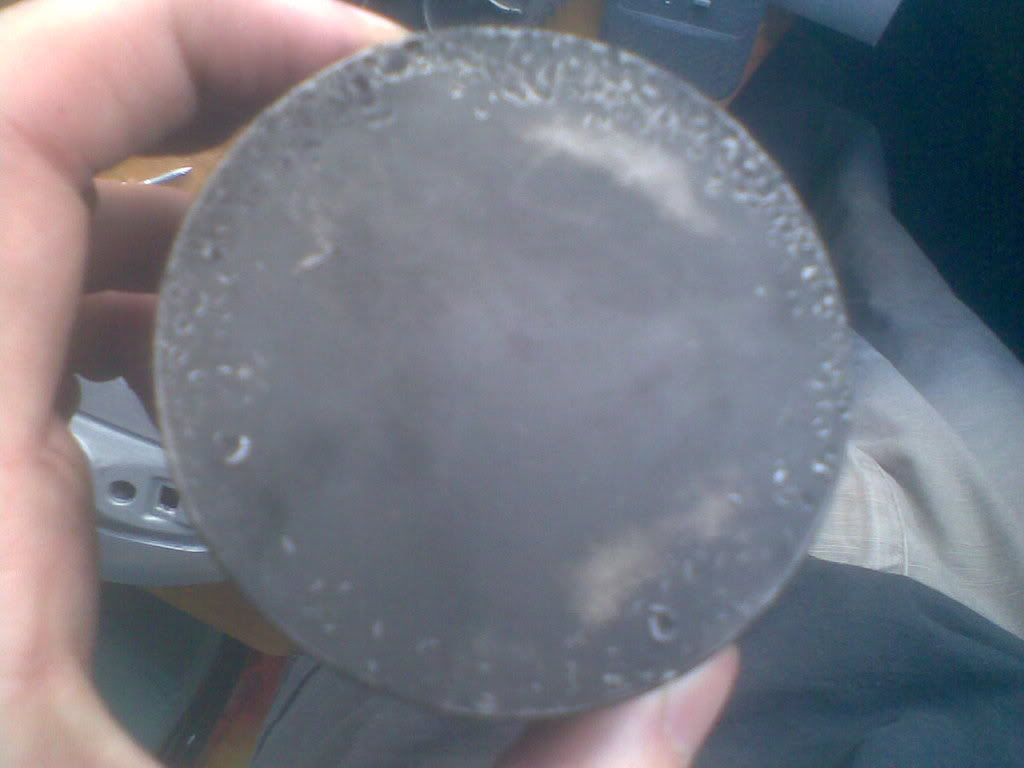

    is that piston useable or will i need a new one?
    also ran into a problem with screws holding the variator together

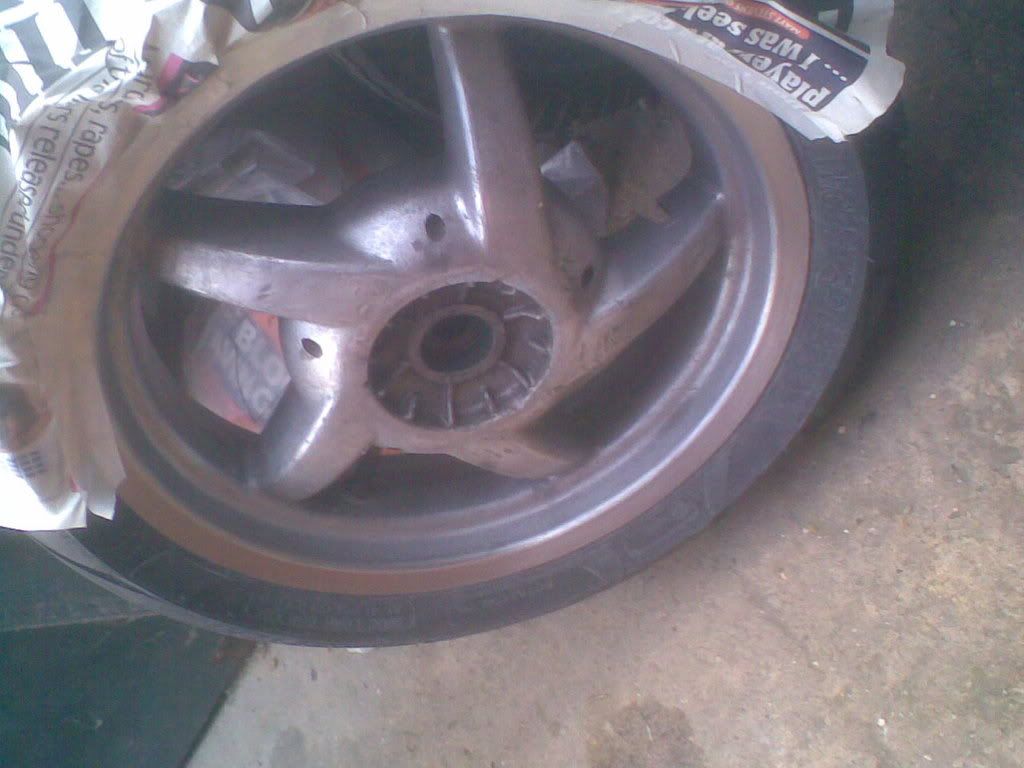

    sanded front wheel for paint and im going to do the front wheel and forks aswel will make a start later today

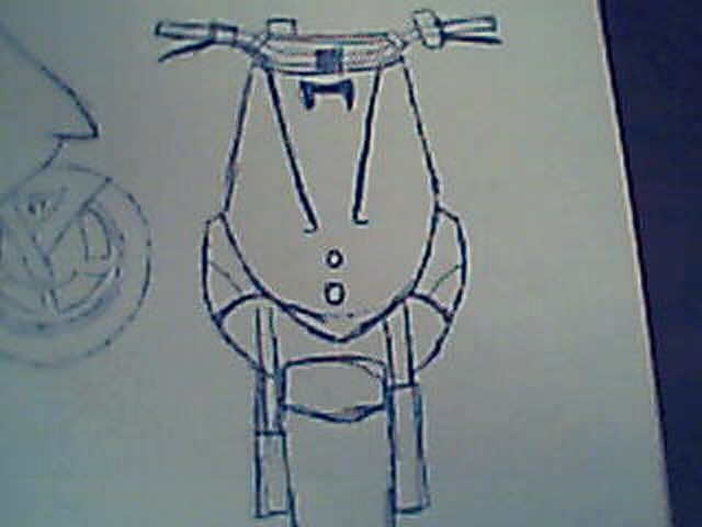

    plan for front pannel
    and ive decided on the paint scheme too its gona be all high gloss/satin black with smoked candy green details want to do doge viper stripes in smoked green on the front pan etc

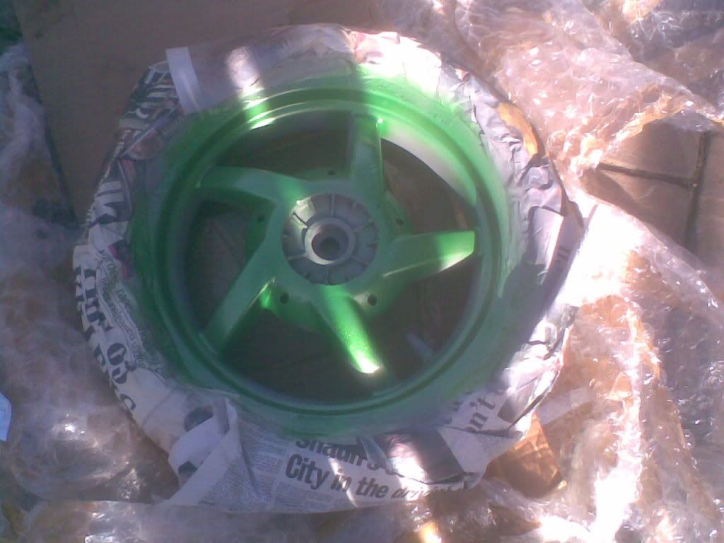

    update
    got some painting done yesterday and today pics dont do it justice its got metal flake in it and it looks bangin in the sun

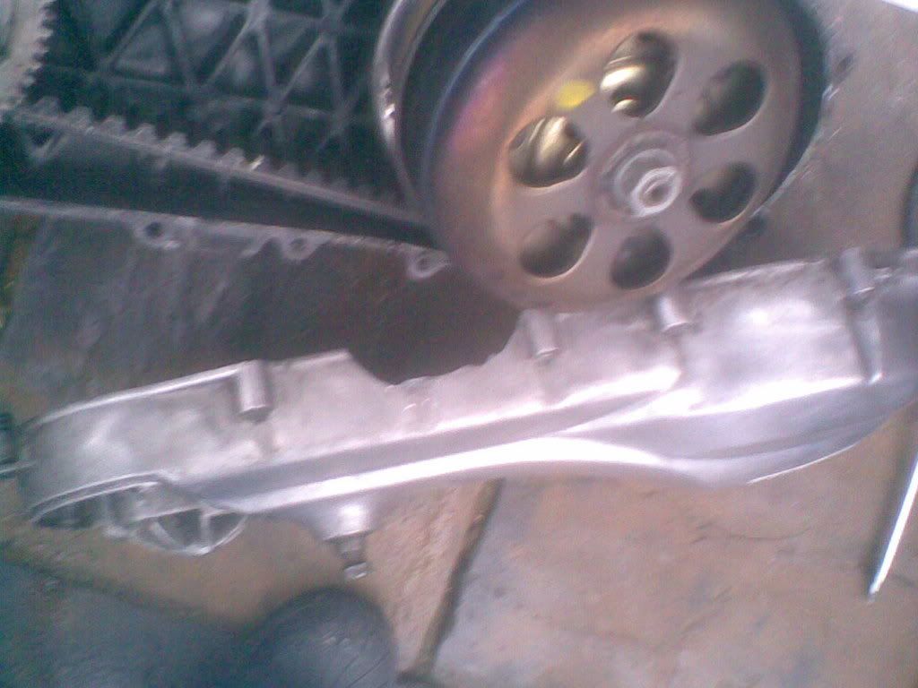

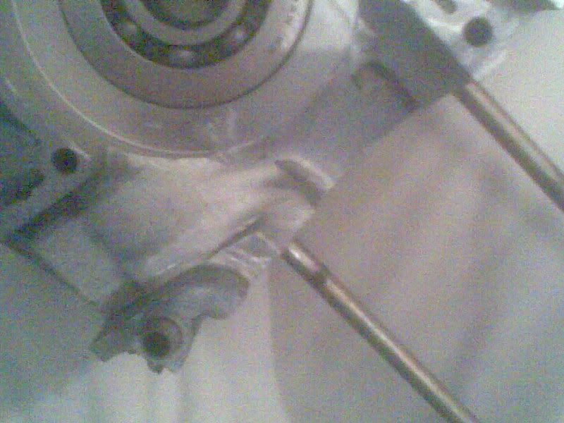

    update :(
  3. MiNoR cOnFuSiOn
    oh my fucking god........ :msn1:
    next time just grind the head of the nut off, remove the rest once the covers off
    oh my GOD
  4. willoughby172
    willoughby172 Member
    156
    wow that not gd
  5. numanoid1704
    numanoid1704 New Member
    1,081
    w
    bloody hell ithought you had only bust the cover :(
  6. alexsr70
    alexsr70 New Member
    2,039
    throw it away and buy a new engine lol
    not worth the possible snappage
  7. shinigamii
    shinigamii New Member

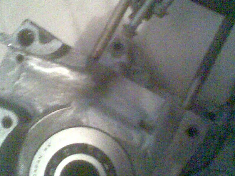

    292
    tits and tits.
    Its worth welding, as stig says in the workshop take it down to a local welders and get them to weld it back on for you. It wont take long according to stig. Ten minutes if the guy can weld properly.
    None of this was my info. It came from Stig.
  8. numanoid1704
    1,081
    w
    i think stig is wrong on this :( no offence stig

    I think Alexsr70 is right. chuck it and buy a new engine.
  10. alexsr70
    alexsr70 New Member
    2,039
    ali welding is alot harder, more expensive too.
    for safety reasons i think i gave good advice, use it if you wish but WHEN it snaps you no why
    oh shit and its in SR mounts........ it WILL snap

    lol i guess i wont listen to the guy at the cbt place then lol he told me it doesnt matter and its only there to keep dust out tbh the metal snapped really easy it was so brittle should it be like that? oh and if any one has any old style 125 ac piggy cases lying around drop me a pm of post in my post on wanted section

    iuts not ali, its magnesium ali and its diff to weld.. first of all you have to COMPLETLY strip the engine and get it all hot (this material contains water) it also has to be PERFECTLY clean (shotblasted is preferable) then it needs the edges redressing as the cxracked/broken casting will literally just blow through befor you get ANY penitration.. basicly not any old welder can just do this job, and even those that can its gonna be HARD. look for a MAGNESIUM welder not an ali welder. price the work up, new engine is cheaper and alot more reliable
    next time, dont hit your fucking ending wiht a big hammer to remove a bolt (never thought id actually have to say that) oh, just to add

    cast mnetal is brittal m8 especialy ally n iron n shit if its stressed its even more brittle its strong in certain senses but if u have a flat peice n smash it wv a hammer itll brealk id get it welded but 150 is proposterouse i could get it done for 20 n u dnt need no ally jus labour u have the peice of all dont u ? as i said ythe weld will be stronger than the rest if hes good lol its an upgrade lol

    New engine time after all.
