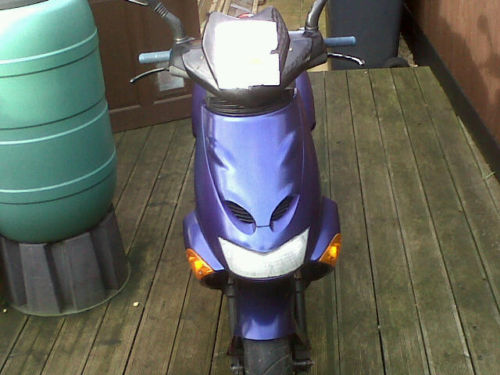

    1.jpg 2.jpg 3.jpg 4.jpg 5.jpg Let me give you some info baught the bike Seems ok needs alot of work tho. but im kinda new to all of this and dont understand half of it but hope for some help!

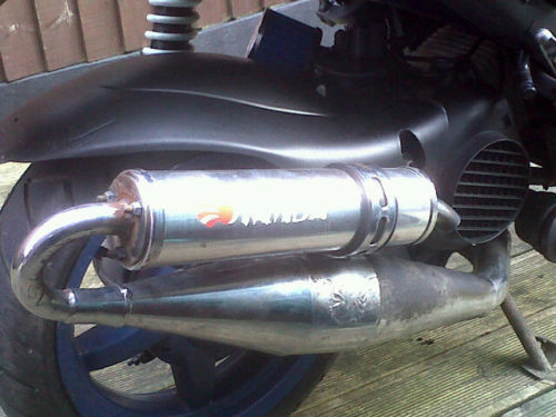

    kundo rapid exhausts

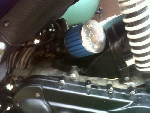

    To be honest not sure if all of this was actually done i know for a fact the 172 kit is on there as i have the old standard 1 in a box,

    I'd get the air cover for cylinder first . Maybe even check for heat seizures.
