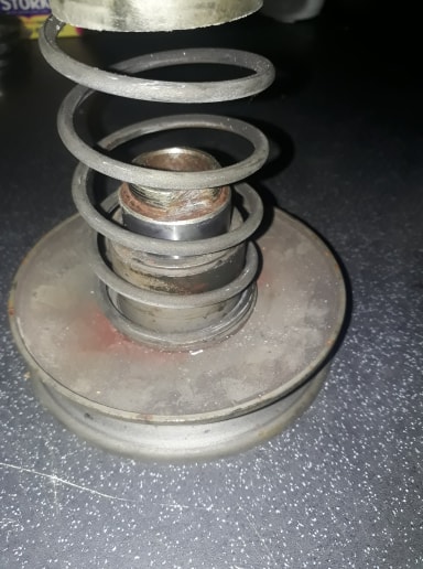

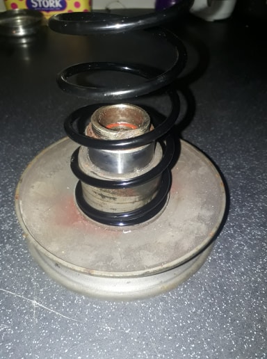

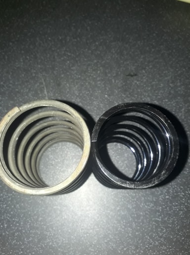

Well guys what i failed to notice until now is the fact that the contra spring was definatelly the wrong one(see photos). i think the previous owner cocked up there i can assume that this is a factor behind my problems
Wait. Huh? I never knew direction of the spring spiral made a difference. Learn something new every day I guess. Nice find
Sounds like its too strong, the winding direction wont mean zip, its a compression spring. All it does is up and down, it doesent twist. If its a really strong spring your engine may not have the balls to push it back and get into 'high' gear.

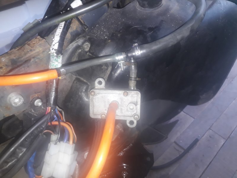

New problem ffs. Right i try to turn it over and nothing so i took the fuel line off the carb n turned it over to find no fuel coming out at all so i thought id hook up a large syringe to some fuel pipe injected some fuel in and low and behold it started then i noticed fuel coming from the pipe that should have been connected to the carb its winding me up loads now the pic below shows the bottom black braided line comes off the tank orange middle vacuum and the orange/black to the carb im sure this is this correct but not 100% if this is right any ideas what could be causing it?
All pipes are clear filter clear also new carb just thought id blow through the vacuum pipe while still connected to engine blew through that deep breath clear Its a stupid question i know but if you blow through that vacuum hose should it get some pressure behind it as i can blow continuous air through into the engine ive never had to check this before? any help would be great
