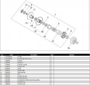

  10. Deikoo
    Deikoo Member
    44
    Piaggio Engine
    I dont know if the spacer is the same or not with the Typhoon, but here you have the partnumber and pictures.
