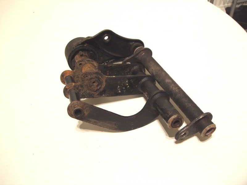

    Ok so here's the scenario, as you already know on a scooter the engine IS the swingarm and is connected to the frame by the engine mount (as shown below) which is a pretty complicated thing.
    But on a normal bike swingarm all you have is a setup featuring 2 shock absorbers at the back and a big-ass bolt with some bearings on it at the front.. Now I'm just about ready to re-fit my engine but on inspection the engine mounting thing is rusted to hell the bushes etc are seized solid, the rubber is perished and the inner sleeves are beyone repair.
    So my questions are:
    Does it do anything other than allow the engine to pivot and remove vibrations from the engine?

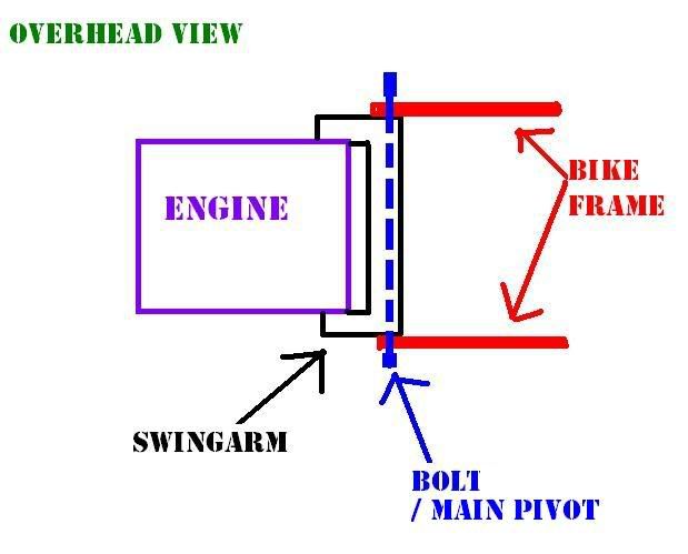

    Could I fuck it off and fit a bike swingarm type setup instead by connecting the engine to just one common pivot point instead of that f#cking mess?
    Like in this shit drawing:
  2. MiNoR cOnFuSiOn
    Re: Any reason why this would'not work?
    basicly a 50 mount... a h section solid mount, it will work BUT its there for a reason. this will make it light in corners on the front and more prone to skidding out. also the engine lifts/bounces about to save shock force smashing the engine to bits.

    That mount acts as a cantilever so like MC says its more to do with when the engine is under load and its trying to stretch the shock absorber, say something like my Zip had your mod I'd probably exit a corner and wind it on only to be high sided as I had taken all the weight off the rear whilst exploiting full power.
    The difference with a motorbike is that all the heavy rotating engine mass is in front of the swing arm pivot were as on a ped it is behind.
    Have a look towards the end of my dyno video to see how it reacts under load.

    not atall... they run no balance shaft.. the whole engine snapping thing is simply as the engine IS the swingarm... so if it cant move upwardss/inwards aswell as the usual suspention movement it will get some BIG shints straight across the weak point, rather than the engine being more of a "floating" lump.
    ive done many a conversion to 2 stropkes an identical way but the vibrations are present and the mounts eat themselves with some fair regularity. plus speed humps are a real smash and run affair. no real reason to do this kind of mod tbh.. cna renew the mount fairly easily/nock somthing up to replace the worn sections.

    well, nock the rusted peice of shit apart. grab some polly/bearings from somwhere and rebuild... there not all that complicated. it can be solid bearing and bush free as long as theres pivot on the silent block, not ideal but still better than removing it alltogether ;)

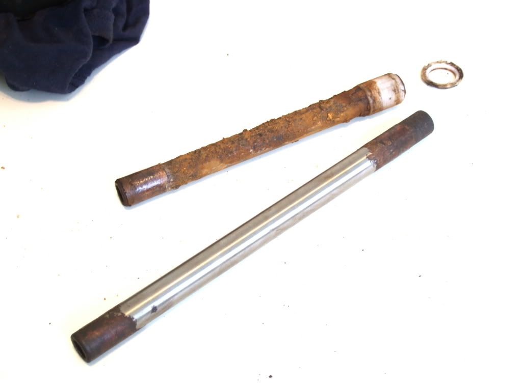

    Well I've hammered them out!
    and
    they're f#cking mullered
    bollocks, if I shove new bushes or even bearings on those f#cked rods they wouldn't last 2 minutes :(
