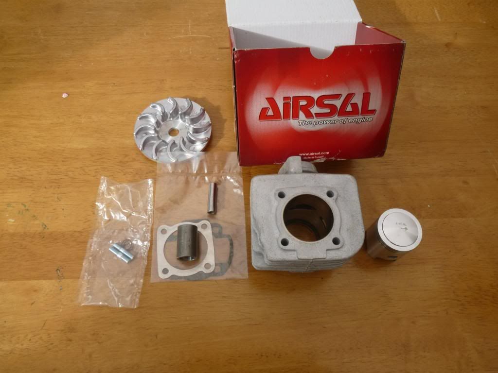

    The kit came, it looks quite a good kit, i guess time will tell.
    Will see what its like once it run in :)
  3. MiNoR cOnFuSiOn

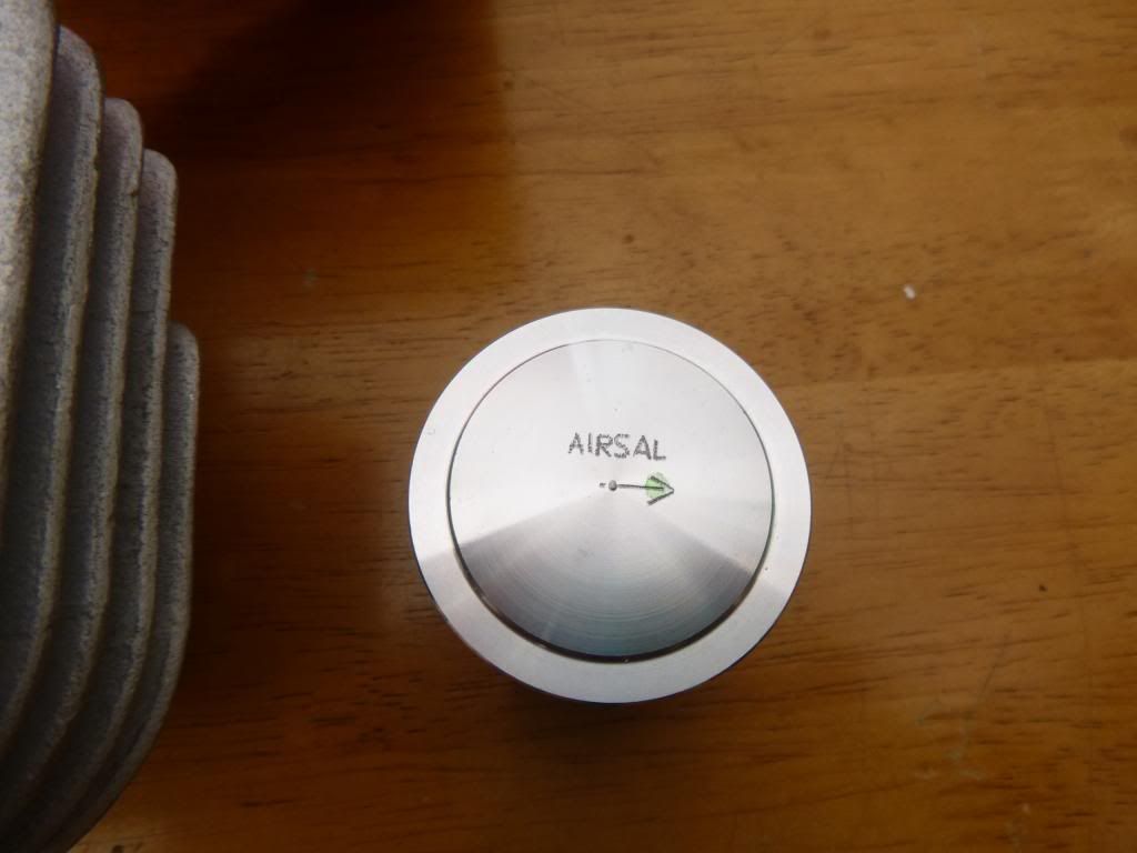

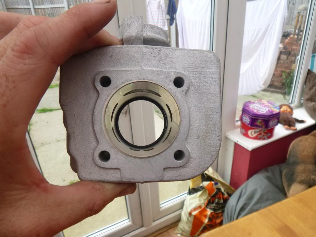

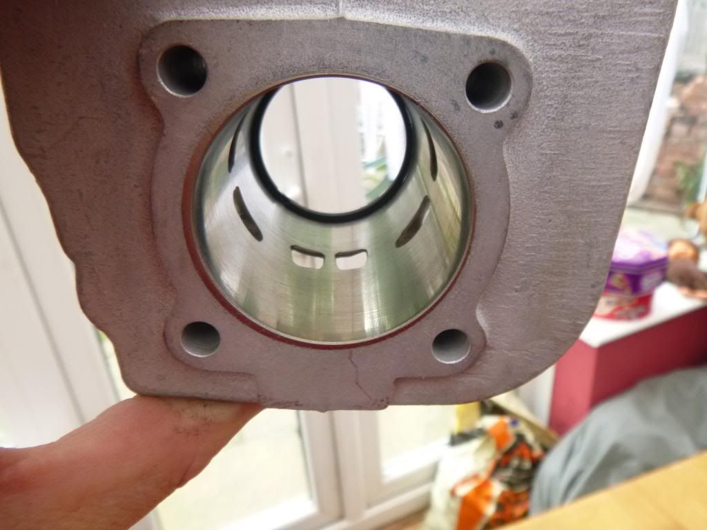

    there cheapo pistons, mahle make a replacment, the head cut is usually a little poor and the ports are lazily cut alot of the time, but this doesnt look too bad, look inside the piston as to who made that.. make sure the squish is correct, you may need a diff base gasget (i used a polini evo gasget kit with mine to get it jus right) altho these sometimes come with a few diff ones. ive ported one to evo spec tho and it was goooooooood fun. not bad for the money atall
