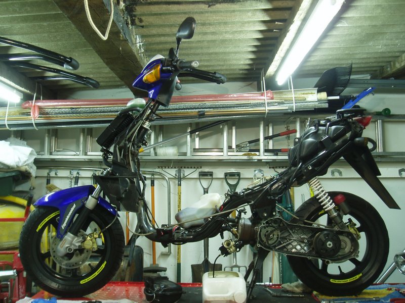

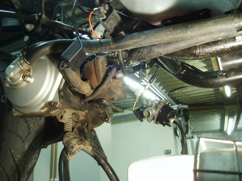

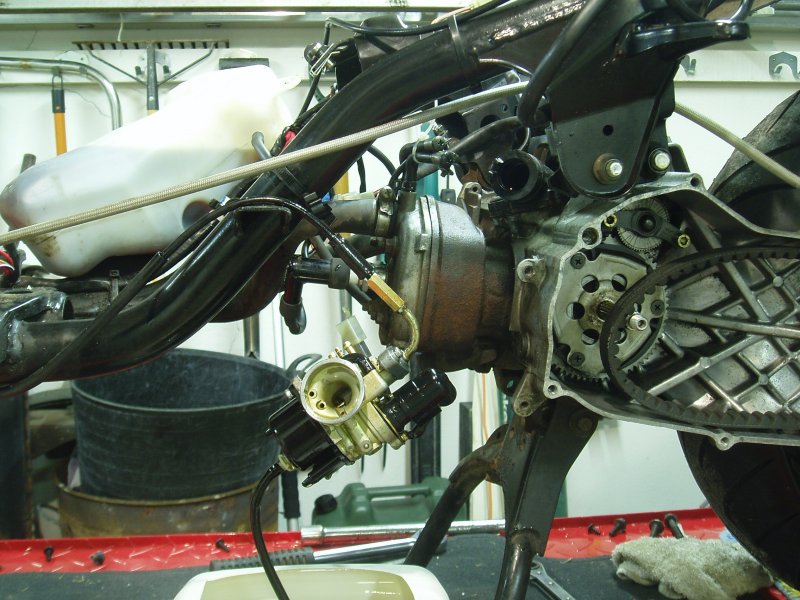

    I have stripped her down again and have taken pictures of her in the nude this time, doesn't she look beautiful :D
    most of the dirt and grit:D was removed from the last strip down, so it has made it easier to get on with the job.
    I have removed the exhaust pipe which I will sell on.

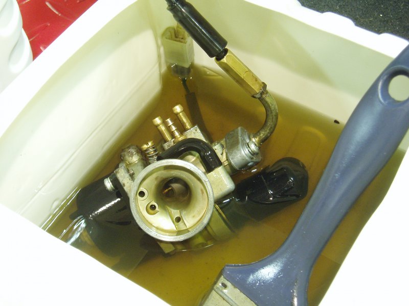

    I have put the carb in paraffin to clean it and I await for a delivery of parts in the morning.
    Aerox project 009.JPG Aerox project 003.JPG Aerox project 006.JPG Aerox project 002.JPG

    Should take the whole carb apart if your cleaning it!

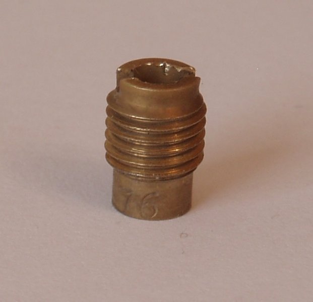

    I did that last time whilst I was removing the jet to find out what size it is, turned out to be a 76

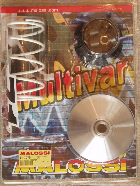

    The parts I was waiting for yesterday did not arrive, and only one part of the order came today,
    when I looked at what I got for 50 quid it made my eyes water,
    I don't even know where it goes :confused:

    I have the malossi multivar on my aerox, much much much better then the standard aerox's vairator!
    To install take the original variator off and swap it for the new malossi one, there should be 3 spacers in the kit? i put the smallest one it to stop some vibration. The rollers for this variator are bigger then standard so if you need to change them make sure you buy the right size (16x13mm).
    To put the contra spring in take the clutch off, this is easy with a clutch holding tool (if you dont have one buy one, mine holds the clutch and it doubles up as a spanner to get the clutch apart!)
    http://www.pedparts.co.uk/product/368/clutch-holding-tool-1
    Be careful doing this as they have a tendency of exploding outwards, use a clamp, stand on it or use 2 people and you should be okay, remove the old spring and put the new malossi one in. Put back together and your good to go! :)
    Also i would recomend a bigger carb 17.5mm or 19mm as the standard Guntner Carbs are CRAP!
    rustyscooter likes this.

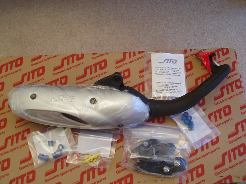

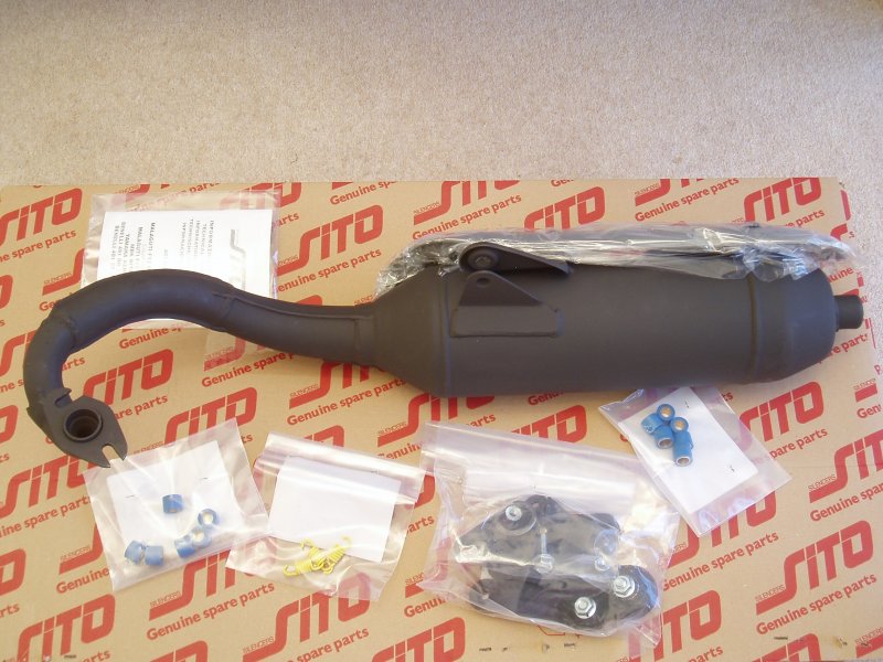

    My new exhaust pipe came today, I can start putting it back together now
  7. scubabiker
    dont forget to take the restrictor out the pipe.
    rustyscooter and scootzmadness like this.

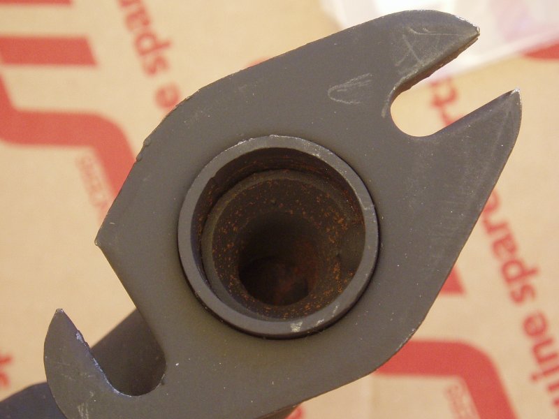

  8. rustyscooter
    rustyscooter Active Member
    380
    Aerox, Harley, Blade
    Is there any particular way this should be done
  9. KyleH
    KyleH Member
    116
    Aerox 11 Plate
    Have a look to see if the restrictor is in the start of the exhaust (end that goes onto the manifold)
  10. rustyscooter
    380
    Yes it is, it is like a funnel in the pipe held in place by a spot weld
  11. scubabiker
    wow it looks like you did that the difficult way, we have a grinder bit for an air rotary tool at work, 2 mins and its out
