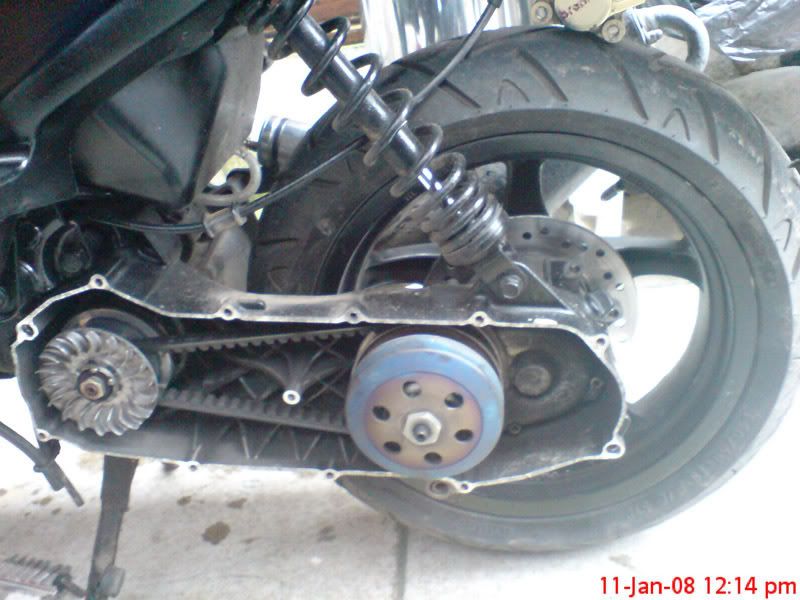

  10. fuj_yammy54
    fuj_yammy54 New Member
    334

    my rollers seem fine. jus took em of wiv ma mates impact gun.. no flat spots on em.. but put rollers bak in and its not duin it as bad.. its pissin me off now..
