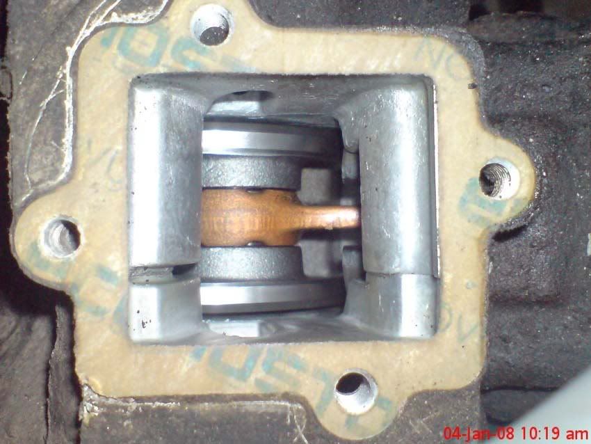

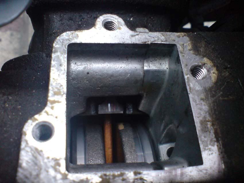

    do you reckon tht this crank can take a 70 kit, malossi sport kit. i thought that it was gonna be in well worse condition to be honest becoz its dun 11k. but i was surprised at the condition of it.. what do you men reckon????
    11k crank..
    11k pison..
    in the bottom pic, if u look closely theres scratch marks on the actual piston itself.. but the cranks absoloutly mint.. i think the owner before frainey was a complete wanker 2 b honest, he must of ran it on shitty garden lawnmower oil.. :confused:arc:
  12. wobbly_trials
    piston has been run hard from cold, you can't tell from looking at a crank, the feel of it is the key to knowing if it's up to the job or not. i suspect not.
  13. MiNoR cOnFuSiOn
    piston is deffo scored to fuck.. nothing a new piston and a quick hone wont fix tho. or a 70 kit.
    the crank itself looks to be worn slightly mopre on mag side as the lil shim on the crank is thinner.. you can messure with the engine assembeld with fila guages between the conrod and shims and compair with the book figure.
    people need to remember if a cranks gonna go its gona go so you might awswell put a 70 on. it would blow with the 50 kit anyway just a bit sooner with the 70. its not MASSIVE ammounts of strain on the crank unless uyour usign an ali kit
