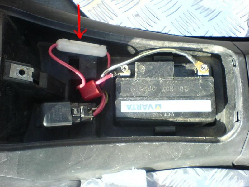

    Cant see where the fuse is near the battery so i took some pics.

    Not sure mate, it's different to mine.
    Try splitting that black box open and see whats inside. Thats if that possible. If not you will have to wait for someone else.
    Follow the wires leading to the battery as well.

    the fuse is in that black box thing in the second pic

    Fixed it, was the relay (box with 27v ) on pic. It wasnt conducting right so i sprayed both parts of the connection with wd40 and it solved the problem :rofl:
    Also checked the fuse and it was fine ;)
