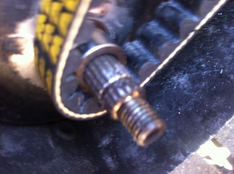

    rite i blew another belt today so i fort it was guna be a simple fix ...I FORT WRONG ...so it has chewed the little thread things the varitor sits on ...at the side closest to the crank and also the bit the that stops drive face from spinning ..pic below of the drive face bit and it is the same on the other side ....
    so i had a brain wave which looks like it will work but not 100% ...so i have taken eleci start cover off and that has allowed me to fit the varitor so it spins with the crank as usaul but it means the belt will not be total alinged and will be a couple of degrees out ..it is a malossi kevlar belt which is brand new ...

    roxy boy Well-Known Member

    Weld it on and sell it on lol

    Or its a new crank for you

    Well u could weld it on for now if u don't want to change the crank!
    Temp fix but not ideal tbh

    Id say u will need a new crank tbh
    like i said u could weld it on until u get the free time to replace the crank

    Mine was just like that! Aerox are shite! And the thread the nut goes on fucked up so now its sat in the garage haha
    the bit that has flattend on the crank on mine still worked.. Just had to buzz gun it on very tight.

    is not that aerox is crap i nearly had something like this on my runner when my belt went , the problem is that no one puts the front pulley on properly and if its not put on with all washers and its not straight it will cause this,
    the thing that you have done now aint going to work as if you would of checked your belt must be rubbing onto your cases and will wear out very soon , also belt will have an angle to rear pulley which will cause a snap again.
    so if you dont wana do bodge work and keep the bike for your self just go for a new crank mate , pm tuning ones are not even that expensive :)

    its not the money am bothered about and i have checked that it is not rubbing and i will get ...a new crank it is just a temporay fix for now it is just fitting the crank that will take the piss
