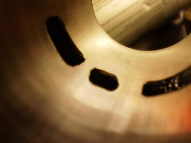

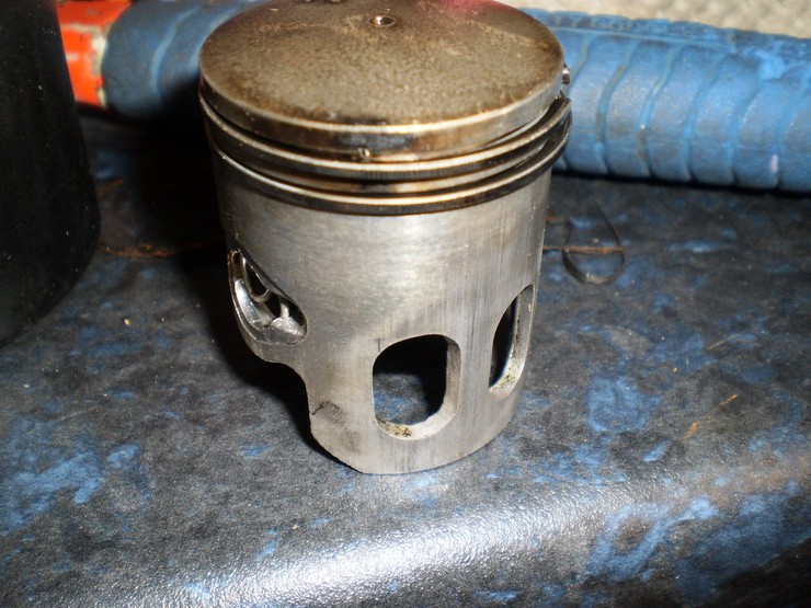

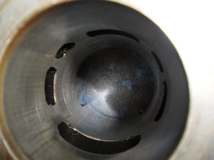

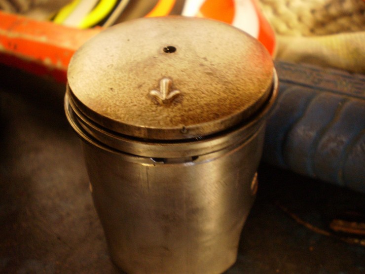

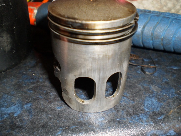

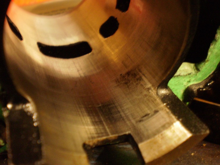

    ok well i have took everything off and there is some scoring but i am still running it in so i dont know if its usual , the small end does seem to be well worn and the big end seems ok no odd movement , can anyone look at the pics and tell me if it looks normal for running in ?

    well i just replaced the main bearings and crank i wiggled that and its fine so i took the head and shit off and that was scored but i have only covered around 10 miles on it looked at the big end all good small end i dunno about seems nackerd but not too sure in gonna replace it anyway
