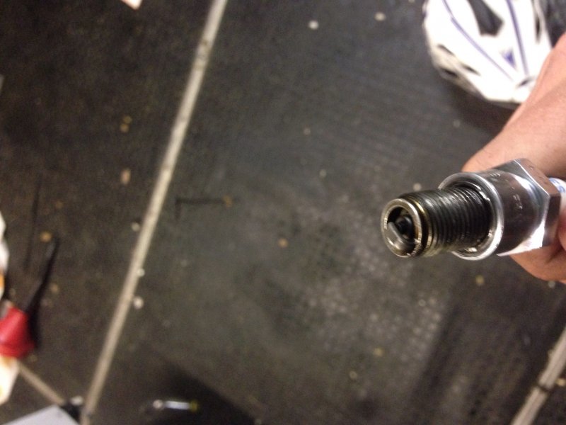

    my aerox setup is
    > s6 streetrace
    > pm tuning crank 10mm
    > 17.5mm dellorto(Manual choke)
    >malossi reeds
    > stage 6 air filter
    > malossi belt
    > s6 variator
    >3.5 rollers
    >malossi fly clutch, it been on 98 jet and running fine and 115 jet and running fine, but yet it is still so lean, according to the spark plug, I just have no clue what this could be I am going to try 120 tomorrow but I don't even think that will work, just want my bike back

    do you have a airfilter in the standard airbox? Or do you have a open powerfilter? If you use standard airbox I will guess 75 -80 jet. I have simular setup and use 77 jet with malossi sport 70cc

    it still runs lean with 98 on airbo(no snorkel)and runs lean with 115 and stage 6 filter

    you're better off leaving the snorkel in, it's very difficult to jet accurately without the snorkel across the rev range, it makes the air flow turbulent, you definitely won't see any performance increase from any increased air flow by removing it.. put it back in an use a much smaller jet

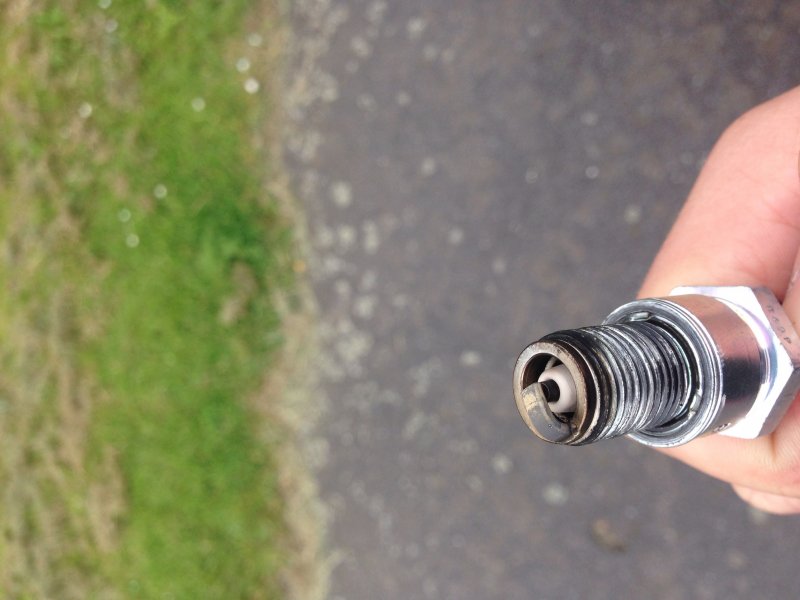

    but I like the sound it makes with my air filter on and here's what it's sparkys like atm 122 jet

    How long do you ride beafore you do a spark plug check? Did it spluttering with full throttle?

    rode it with old sparky then I put new it held throttle for 10 seconds turned bike off and no it didn't splutter with 98 jet in with s6 airfilter and it doesn't with 122 in

    you have to ride much longer to get the right color with new spark.
