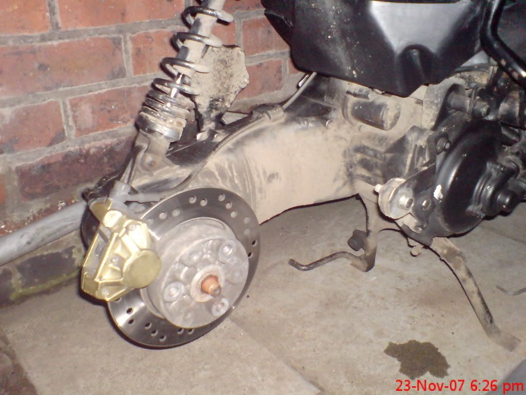

    ive took ma bak wheel off and i was wondering how i take my back disk off.
    the front ones easy so i know what to do with that 1..

    at a guess mate i think its connected to the clutch (inside tranny case)
    Whip ur transmision cover off and see if theres a center nut in the clutch you can undo
  3. Jamie
    if its the same as piggy engines then two allen bolts hold on the back brake..disconnect this..then one main bolt in the middle holds the actual disk on.

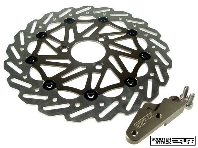

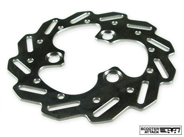

    coz im gettin these beasts..
    this one for the front
    and this one for the back..
    make it look well betta. superbike style..
    "we all want the power, but you gotta be able to stop.."

    the disc is bolted to the hub, which is the big metal thing on the end of the shaft, undo the main central nut, pull the hub off adn the disc is held on by allen bolts.

    o rite.. its all making sense now. the bolts are on the other side of the hub. thanks people..
